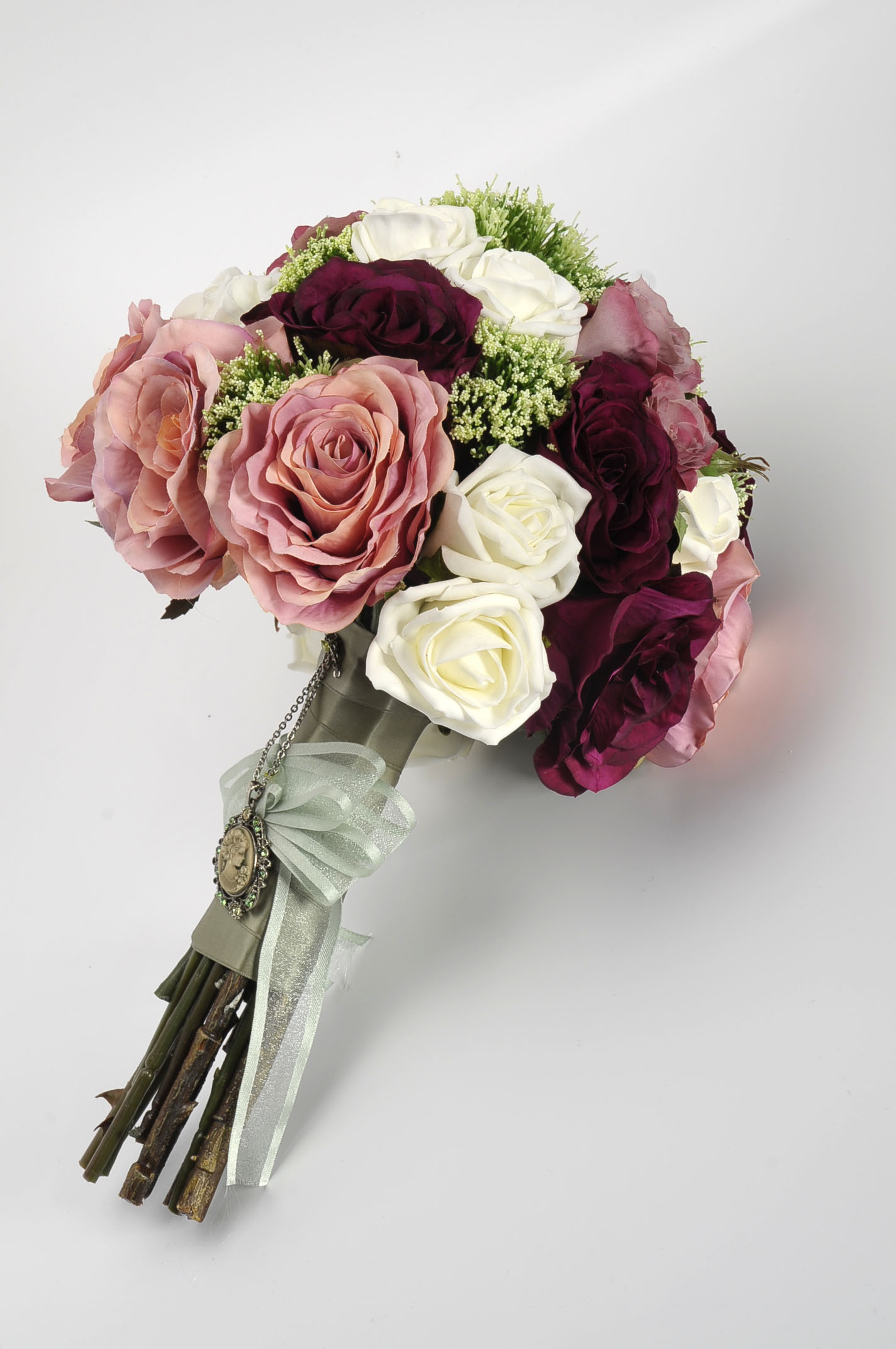

OK, so I finally got the 70cm beauty dish and the Lencarta honeycomb didn't fit it. The little wing cips just don't fit over the rim. Not to worry though, I've managed to attach it using some strong corsage magnets and it's sitting perfectly inside the rim. Genuis!
Now to the test shots. I've set up like this:
The beauty dish is silver lined and it's fitted with the black honeycomb. The silver deflector is fitted inside the flash unit.
The overhead flash unit is turned to 1/4 power and it's lined with the .9ND gel. The beautty dish unit is set to full power.
The flash units are being triggered by an IR trigger.
The camera settings are f13.0 at 1/160 and ISO 100. The exposure compensation is set to +5 and the focal length is 70mm (at long as this lens permits).
Here are the results (getting there but I'm hoping one of the gurus here can help me tweak this even more to achieve perfection):
Any help or suggestions would be greatly appreciuated. I'd be keen to create darker, more defined shadows. Would you agree?
If you get rid of the trestle table and bring your shooting table (equivalent) away from the wall you will be able to control the light reflected from the wall/background, which will make it easy to control the local contrast.
And if you can move the beauty dish further away you'll get a progressively harder light too, and the lighting will be more even from one side to the other. And if the angle of incidence is more acute that will again increase the effect.
I think that Elinchrom may have changed their beauty dish,the Lencarta honeycomb always used to clip on nicely.
Still looks under exposed to me making the colours a bit drab. Perhaps a bit more light from above - I downloaded your JPEG and just increased exposure by half a stop here (hope you don't mind - if you do, let me know and I'll remove it):
seems to give everything a bit more pop and colour. Perhaps turn up the overhead light half a stop (1/4->3/8ths power - I think that's right...). Also, in the increased exposure, you can see a streak of light diagonally top running uphill from left to right above the flowers which I assume is from the beauty dish. Not sure how you need to position the beauty dish to remove this (I think it comes from the beauty dish light being more powerful than the overhead when it hits that bit of paper) but at a guess, lower down than your photo shows so it is more glancing on the paper and further away. Upping the power of the light above will also help as the ratio of beauty dish:overhead will change brightening the background around the streak making it less obvious.
You may want to try altering the angle of the overhead light. Whilst it isn't producing well defined shadows, if you have it coming slightly from behind angled forwards and down, you might be able to get slightly more relief in the flowers.
I will put my general caveat in here that I'm no product photographer, just an individual going through the same process myself - albeit with different subjects - and this thread is really making me think about what's causing different things to happen. What I have found out is that relatively small changes can make big differences in the perceived results. Experimentation and understanding what you have changed and how it has affected the result can sometimes be very illuminating (!).
Some other things you might want to ask yourself.
  • Do you have a calibrated monitor to show the exposure/colours correctly? If not, it is worth the £100 to get something to get it right. It's surprising how many screens I've calibrated (and recalibrated) with mine over the last year I've had it, so it doesn't now seem like £100 on a single use item.
  • The image above says it was edited with MS Photo Viewer. If you don't have one, it might be worth investing in a better software tool to make your workflow simpler - I use Lightroom here and it makes import/global changes really easy on multiple images as well as being able to manipulate the overall picture. I think it would probably suit your workflow down to the ground.
  • How do the colours you are getting from camera look compared to the object when it is in your hand? I've very recently invested in an X-Rite ColorChecker Passport which has just given the final kick to pull the colours back to how they look in real life. Take a look here: http://www.talkphotography.co.uk/forums/showthread.php?t=366035 for what I mean (this integrates really neatly with Lightrooms workflow).
Whilst these points won't help with getting the lighting setup correctly, they do need to be thought about to enable you to produce the best images you can as quickly as possible.
Aha! Another thing with the colours as my saved image has gone drab again (although the exposure looks better to me at least). The image you have shot says the colour space is "Uncalibrated". When I render it in Photoshop with Adobe RGB (1998), it has a nice colour pop. When I save it, it converts to sRGB which is "internet colour space" which subdues the colours. What colour space have you got your camera set to? If you can, switch it to sRGB....
When you say to move the shooting table away from the wall, by how far do you think I'd need to move it? The curved white background I'm using is attached to teh wall, so might cause a problem unless I either purchase a real shooting table or build a makeshift box with curved background.
I get what you're saying about the angles, so I'll raise the height of the beauty dish and then point it more downwards towards the subject and try moving it further back. How much further back do you reckon?
At the moment, I'm not using any reflectors. What position do you think might give the best results (if any)?
Not to worry about the clips, I've attached it firmly with corsage magnets. Just thought I'd let you know they don't fit one another.
I think Garry is saying the opposite - lower the beauty dish and have the light glancing across the flowers. That way, you will get more shadow from the petals.
It's quite easy to experiment (if you have a reflector!). The key thing to remember is the physics of light - light essentially bounces off the reflector at the same angle it hits it. You need to draw a line in your brain between where the light is coming from and where you want it to go and position & angle the reflector accordingly. Also remember the inverse square law in terms of how far the light has to travel (i.e. a reflector close will bounce more light in compared to one further away where the light has to travel further).
The first thing to say is that as the side walls aren't even in your pictures, all they are doing (the white card on both the side and back wall) is giving you fill light much like 2 sides of a light tent would. As it stands, you have no way of controlling that fill light other than moving the subject away from the walls.
If you moved the table a couple of feet into the room, and took the same photo (softbox above and beauty dish to one side), the lighting you'd get would be harsher as you don't have the fill light from the walls. You could then add back in some fill light by moving a reflector (which may be just a piece of card) of some sort back closer to the subject. However, you can control the distance and angle it is placed and hence it's affect on the image. With the table backed up into the corner, you get what you get with no control. It may produce the lighting effect you want, but it'll be more luck than judgement.
