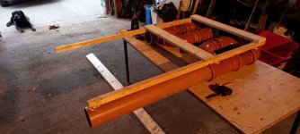

Has anyone built or tried a floating hide? I maybe spend too much time watching YouTube and have seen a number of wildlife photographers using them in lakes to get close to and get a nice low perspective on water birds. This is what I have came up with so far and at least it floats. The timber is in one piece and I have added a piece of 3 x 2 across it with a tripod head bolt up through it to hold a gimbal head. The 2 pieces of sewer pipe have bolts sticking up and fixed in place and the timber is held on with 6 wing nuts. 4 bolts are sticking up at the 4 corners and the blue pipe just pushes on, these hold a camouflage tarpaulin and then a camo net and this is held in place with elastic toggles to hooks on the timber. A few minutes unpacks it from the boot of the car ready to go on the water.

I have got all the bits ready to build mine, but i'm getting a knee replacement next week, so it is 'on hold' until I can get around again.
Similar to yours, but with 5" pipe all round and extra cross braces at front, a marine ply wrap-around 'deck' area with a couple of hand grips and gimbal mount attached. Similar frame, to support the 'camo' fabric.

Large areas of the lough shore have permanent shooting hides out in the water for duck shooting and there is numerous slipways around it where there is regularly large numbers of jetskis, paddle boards, speedboats etc. I suspect that the only places there would be a problem is like Oxford Island which is a nature reserve.

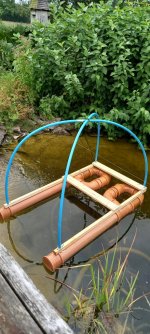

I was surprised to see how buoyant it was, the photo above is my garden pond and I got in and tried it. I gave ply cut to cover the deck so it feels less open. I do a good bit of kayaking and always wear a life vest and I will be using it here too and have a waterproof case for my phone in case of emergency.

Mines along similar lines to yours but a bit more rough and ready. The one difference is where I attached the screw for the gimbalI had it lowered so the wood itself was at water level. The gimbal then raises the lens just a few inches off the water line, and will be lower than yours - and at the risk of opening up the jokes - every inch counts!

Cheers for that Mike. Love the grebe with family shot, that is what I'm hoping for. I am going to try the gimbal as it is for the moment until I see what it is like and how choppy the water may be but I can easily work something to lower it if necessary. The low pov makes the images.

The wooden piece unscrews from the pipes with 6 wing nuts and both sections of pipe are seperate. The 4 pieces of blue pipe just lift off and come apart where they meet at the top.
I attached the tarpaulin and camo net together , it just throws over the top and 6 pieces of elastic go over hooks on the wooden frame. It will fit in the boot of any car and build up in a few mins. I am self employed and have a van for work so can set it into the van in one piece without taking it apart.

Thanks Dale. I had the camera an inch lower than this for my attempt yesterday morning and am going to go another inch lower again when I get time to alter it. I have been going in to the water at 6.30 at a little used slipway so haven't seen anyone so far! Lough Neagh where these were taken is the largest lake in the British Isles at 150 square miles so there is plenty of quiet areas.
