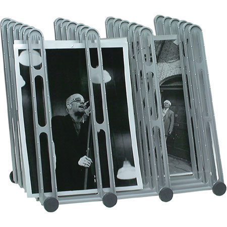

I have a peterson rack for drying, one of these
But I don't think it's the best thing really.
I haven't much room to make/install a rack with screens.

They stick together at first, yes. That's the whole point of it. They come loose as they dry, and so don't start to curl until a lot later on in the drying process. I imagine you could do it with that rack thing, just slot them in back to back. I don't know, I've never used one, but it's definitely worth a try :thumbs:
