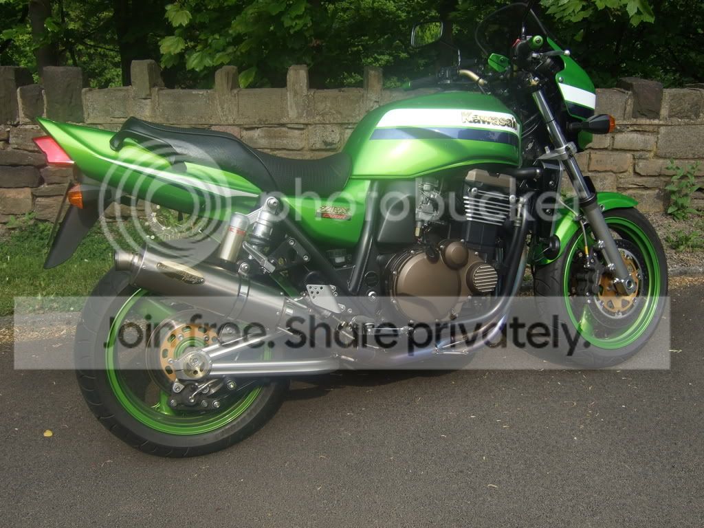

i recommend a motorbike, large intercooler my arse, large bike and a large set of balls win win

Lol you won't get me back on bikes, those days are gone :(

My car is probably more practical and harder to steel. A cutter grinder and that will be gone quicker than it will accelerate. That and on wet days if you do go out on it, you will be mincing around on it holding people up.:D
