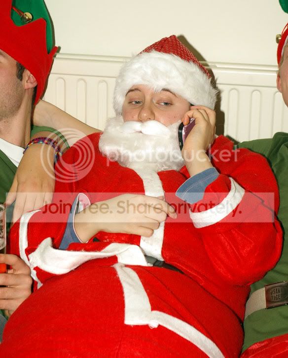

Harsh light from direct flash

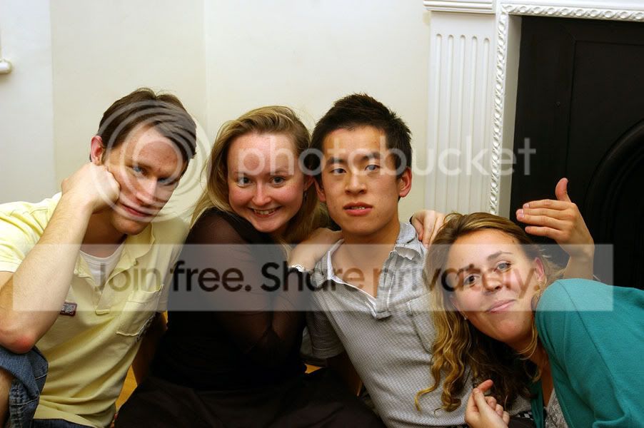

An OK shot where the flash was bounced off the ceiling

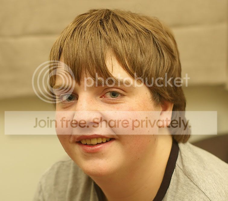

Yellowing due to flash bouncing off ceiling

Your bounce flash stuff looks just fine to me. If you shoot raw the colour balance is not an issue. If you shoot jpeg, it's still not a big problem.
Opened in PS, auto colour and closed. Looks OK to me, perhaps the time spent making a final adjustment may be worth it to you.
If you're there to do pap stuff, you are documenting the event and it's actually more about substance over style.
Of course if it's a big place you may not be able to bounce the flash anyway.
