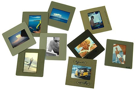

Oh and in case it wasn't obvious (we haven't plainly said it), it is slide film because the pictures were delivered mounted in slides:
It wasn't obvious enough to me ;)
How big are those slides? Normal slides you put in those old photo projectors? And I presume these positives replace the normal negatives you get with traditional film?

Those slides are about 50mm square, they fit into a standard 35mm projector. You do get positives instead of the negatives. Be mindful though that to project them they need to be mounted in plastic/card mounts like in the post above. Did you ask for them to be mounted when you took them in for processing?
You can get mounts and do it yourself but you have to cut the positives into single frames and getting them in the mounts is notoriously fiddly according to my dad. Plus as your handling the film its easy to get scratches/fingerprints on them.
