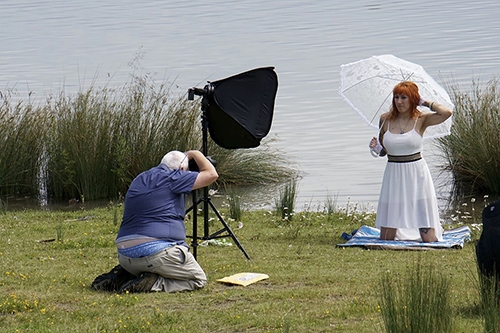

I almost exclusively use my 70-200 but always with off camera flash.
Builders bum
by metroman on Talk Photography
Some "good friend" of mine captured me at work photographing Anna recently and this is the result.
Anna
by
Brian Lewicki
on Flickr
I used a Nikon SB800 mounted in the stand and softbox with a YongNuo YN-622N Wireless trigger on the flash and a YONGNUO YN-622N-TX i-TTL Wireless Flash Controller on my Nikon D700.
For some reason I used f13 on the lens and can't think why??? I can't tell you what the power output of the flash was but quarter power is quite normal and I might move the flash nearer or further from the subject as required. Looking at the finished image it clearly shows I used flash which is not always desirable but I like the image non the less.​
