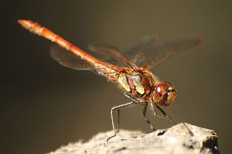

Took this in the garden with a Sigma 70-300 + Jessops' tubes (would not have got anywhere near as close without the tubes):
