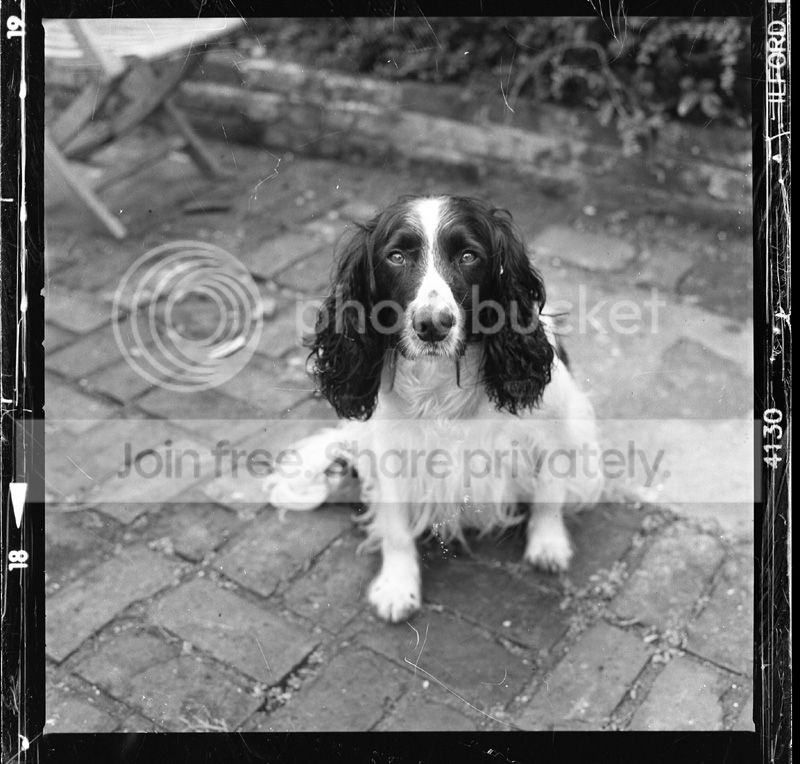

Although loading the back was a doddle, loading the Paterson spool with 120 was a struggle and it kept coming off the reel. I pulled it apart and started again a couple of times and I nearly gave up at one point! However I persevered and after an hour long wrestling match, during which I added a lot of scratches to the film, it went on.
I don’t have a meter (and was too impatient to wait to get one) so my exposures were guessed and most were a little under. This one shows just how much abuse that poor film got during loading onto the reel;

Yeah, but what a cracking job on the focusing. Great model !
are you sure they are scratches Mark ????
Lubricate the bearing in the reel with a little graphite from a pencil. It should keep things moving nicely. Ilford films are usually good to load because they have a fairly thick base material that is relatively curl free.
