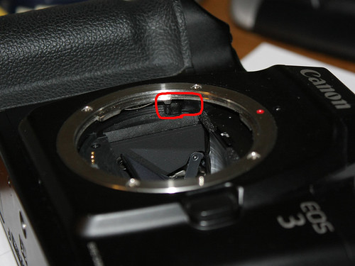

Okay - I've done a bit more research into that microswitch thing - if you have a "chipped" adaptor ring, the switch needs to be open (as opposed to it's natural closed state - as in the photo below)
If you have a non chipped adaptor ring the switch needs to remain closed. I've got both types (albeit for Contax/Yashica rather than M42 - but it's the same on the camera side regardless). Both of my adaptor rings have bayonet fittings that are too short on the relevant bit to operate the switch - therefore the dumb adaptor works without wedging, but the other needs the switch wedging open.
If you fit the adaptor ring without the lens, on my adaptor, you can just see the switch is not opened. I'd be prepared to put money (well 10p in the charity box at least) on your adaptor having a bayonet tang that's long enough to open the switch. When this happens, the camera looks for a chip to define what lens is attached. This doesn't happen, as your adaptor hasn't got a chip in it, and the camera gives a "I can't understand this lens" error. If you fasten the lens on, but leave it just short of clicked open, the adaptor tang doesn't operate the switch, and it works fine. All it needs is a small amount of metal removing from the corner of the offending bayonet tang, and you should be able to click the lens home safely, and be sorted.
I think that this may illustrate what I was wibbling on about...
The 2 red lines mark the top and bottom of the bayonet tang. The bit of the tang scribbled on in blue ink would be the bit that was too long, and operated the switch when you didn't want it.
Obviously, the side shown in the shot is the bit that goes into the camera :)
I reckon 30 seconds with the dremmel would see it right :lol:
