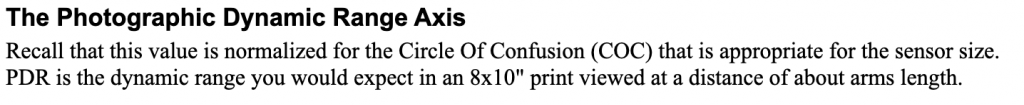

This also applies to the DXO testing, because their tests will have this exact same issue when measuring details in the shadow areas.
