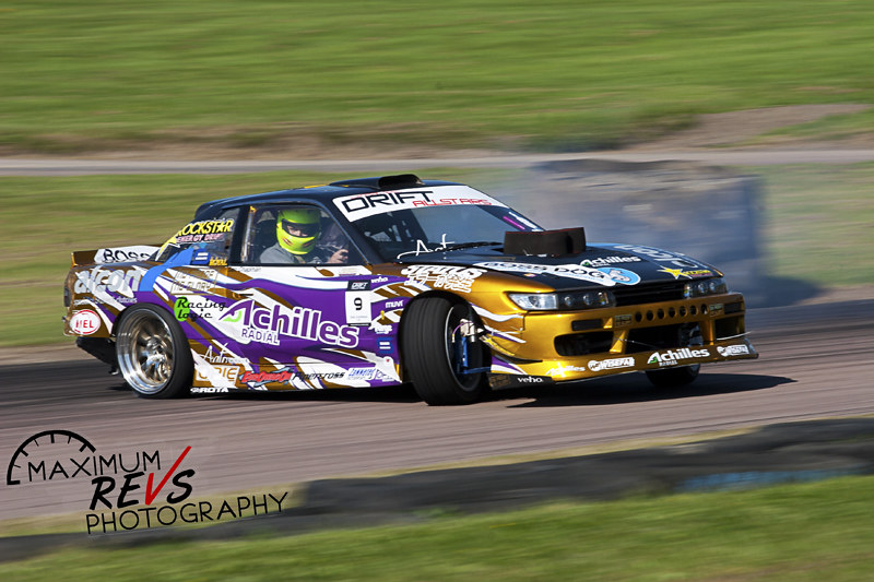

Morning Devils elbow for shots like this: shot at 1/125th
aNGLE by Maximum Revs Photography, on Flickr
