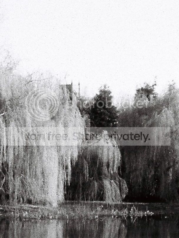

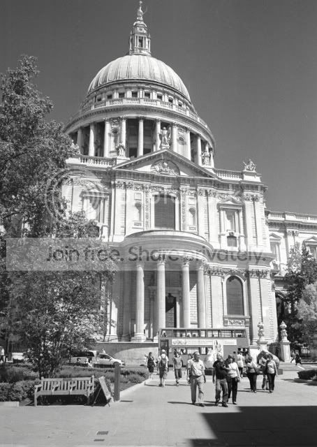

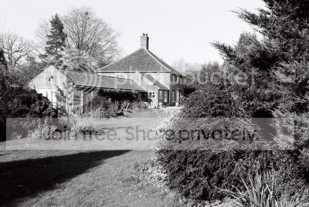

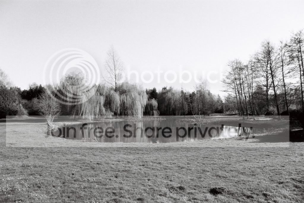

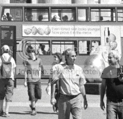

OK, I have uploaded some of the mid-res scans to photobucket plus a portion of one of the full size scans. Now I look at the scans in more detail they look even crappier than I initially thought.

It's mainly the first one that looks really bad to me. It could be the result of interpolation. What do they look like when you scan at a lower setting, say 2400dpi?
Also, how much PP did you do? Some scanners don't deal with B&W very well at all, so the contrast has to be fixed with some quite heavy handed compensation. I had a quick play in gimp myself and it seems there's a lot more detail in the scans that's just washed out by the brightness.
I didn't do the scans as I don't have a negative scanner. I had them done by Ilford labs while they did the D&P. The first one is a cropped version of the highest resolution scan as the full sized image was too big to upload to my free photobucket account but is a good representation of what the original looks like viewed at full size on my 30" monitor. The other images are medium resolution scans.
I suppose what I wanted to know is whether it's the processing that has been messed up or the scanning although possibly one cannot tell without scanning the negative again in another scanner. Perhaps someone could point me to a high resolution scan of a 35mm negative so I can see how much grain I should expect.

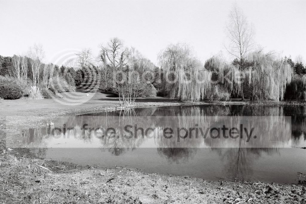

I have taken one roll on FP4 recently and for what it's worth here are a couple of frames (one resized, one crop) to give you an idea of the tonality and detail I got with a Canon FD 50mm lens, an orange filter, developed in ID-11, scanned on a Minolta 2800dpi scanner. The images are as they came out, unGimped for contrast or anything (excuse the water marks!)
Resized
Crop
I'm not saying these are any good by the way, I'm just offering them for comparison.
