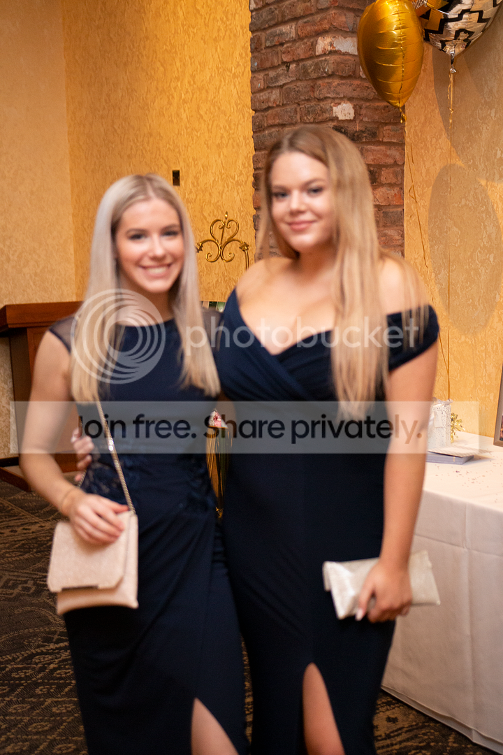

I was really nervous about the 50th birthday as I knew it would be low light and a lot of people there. But after I got going I was ok.
But I was struggling, mainly with focusing. Sometimes it would just not focus on the people. I don’t know if you guys can answer. But I have a feeling my single focus point may not of been on the subject?
As you can see from this pic the girls aren't in focus one bit, but the background is. I would of tried to have the single focus point on the girls head, is that right?

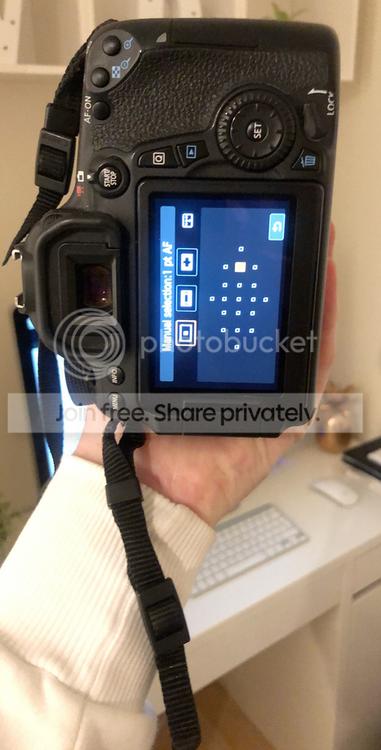

Would you put the point on the girl on the rights head?
At some point I couldn’t even focus the lens on the subject, this was prob because it was too dark? Because I moved them into better light and it worked ok.
I had the flash pointing up to the ceiling the whole time. It was fairly high, but was white. What happens if I direct the flash on the subjects face? Is that a no go?
Towards the end of the night my ISO was at 6000 and when I uploaded them to light room they were grainy, but that would be because of my ISO?
I kept my F Stop on 1.8 most of the night.
Hi Will @willkia
Firstly, forgive me as I am sure I am repeating myself in regard to giving this advice on one of your other threads "you choose your focus point" ..................so let me say it again!
You should choose the focus point to suit the situation and the type of subject.
In the case of the ladies above and the shot you show of the camera back the reason as I see that they are OOF because is your chosen FP was between them on the back wall! If you had chosen the FP at that vertical position but the one to the right of the one you have used you could have focused on her right eye (or used the left hand one of those 3 Focus Points and focused on the left eye of the shorter lady) this would would have ensured they were both in focus and your composition was maintained.
Can you confirm that you understand what I am describing???

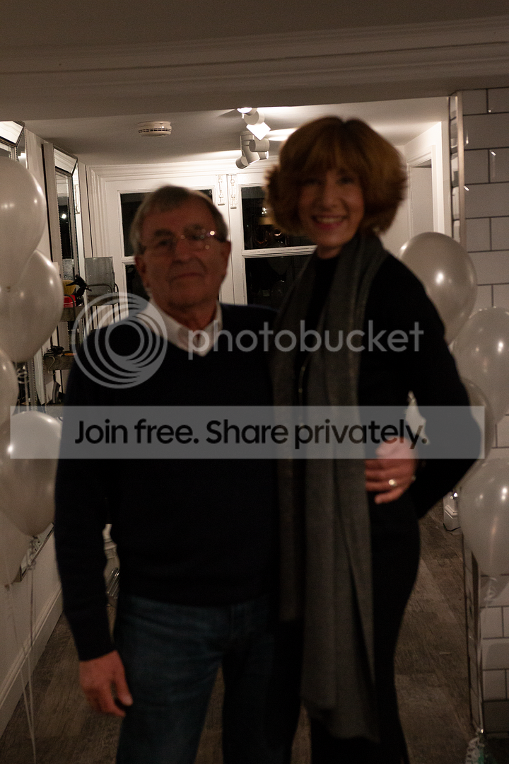

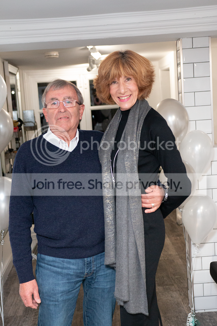

In regards to the salon, it was so much brighter so it was better.
But some pics came out like this (as if the flash didn’t go off, but it did)
As you can see here, they are in focus
But god knows what happened here?

In regard to this one....................I agree about the flash recycle time as mentioned by @andrewc
But based on the FP choices issue you are struggling as talked about above.
Re: in regard to the OOF issue in the second picture ~ In the initial picture I surmise the focus was on the lady's hair........................but in the second shot she moved and you focused on the window frame in the background.
A simple technique for making sure stuff is in focus: like Dave said, use the centre focus point. Before each shot stick it over the bit you want in focus and half-press the shutter button to lock it, then swing the camera away to re-compose the image how you want it. Practice doing it for EVERY shot. It's not necessarily the *best* technique, but it will reduce the OOF failures.
IMO ~ Focus & Recompose ~ to use the methodology the OP needs to understand the basics first because I fear that as he insists(?) on using f1.8 and at the apparent close in distance of the posted shots he will find other OOF issues that he will not appreciate the reason for it happening and the explanation will more than likely flummox him.

On that first one of the two ladies, perhaps the camera was drawn towards the prominent clutter in the background, because my eyes certainly were! It's not just the 'technical' aspects of focus you need to be looking at, it's your composition of photos. In addition to learning how to operate a camera, learning to 'see' a photo is an essential part of becoming a good photographer rather than someone who takes sharp-looking snapshots.
If you want to improve and become a good photographer you'll take a good hard look as some of the photos you've posted as examples of your work and ask yourself is there anything wrong with them? In doing that you'll need to look at the photo as a whole, not just the bit you intended to focus the camera on. Until you learn to 'see' then no matter how well you learn to operate your camera, it's still going to be more down to random chance and probability rather than good judgement if you manage to get a good result. That photo of the two ladies might just have been the most important shot you've taken since you bought your camera... in terms of it teaching you how to 'see'. I hope this is useful.
