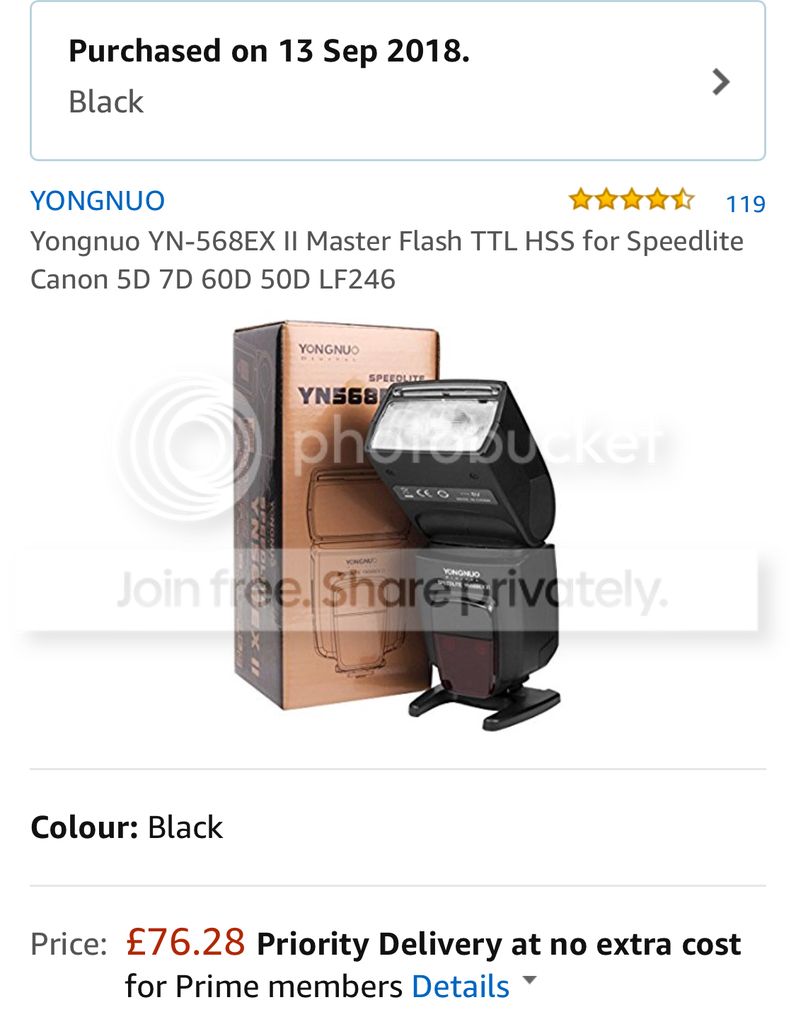

Thanks guys
I’ve just ordered this
I mentioned to the girl that I’ve not had much experience using low light and I said I’ll get better over the next 4 weeks and she said it’s absolutely fine and would be happy with iPhone pics

Thanks so much, but i've just bought a flash.
I am going to go for it guys.
The flash comes today so I have 4 weeks to practice.
