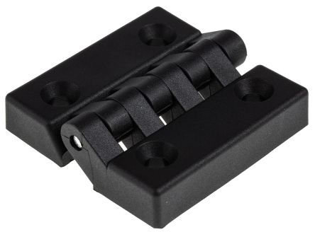

To be honest, I could probably find a 270 degree hinge and fit it into my design but I'd still need to build in a support/locking mechanism to allow the rear standard to rotate and fit in line with the base when 'closed'.
I was thinking about this sort of thing:
Steve.
Steve.
I could possibly use a hinge like that. The main consideration is that the actual hinge point needs to be 20mm below the bottom of the base to give enough clearance for the rear standard to fit flush, including the ground glass panel. Can you send me a link to those hinges so I can check their dimensions please?
