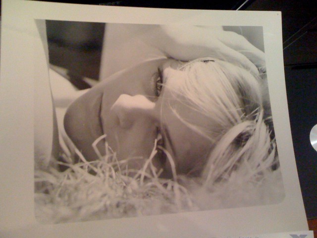

I've just added a shot to flickr taken with my phone. Unable to scan it as my other half has seemingly already packed it for our move.
First wet print, a decent first go I think! by mahoneydanny, on Flickr
I think I'm mahoneydanny on there, it's probably shocking quality, took it with an iPhone 3G, still, let me know what you think!
Shadows are fine, mid tones are fine, highlights are blown to buggery. That's not the case with the negative, it's scanned fine previously, so definately something I'm doing whilst printing. I used kodak rc paper with a grade 3 ilford filter, no idea if the filters work with this paper?!
Any ideas?
Kodak papers are higher contrast than the equivalent grade ilford paper, maybe try increasing the exposure a touch and putting a yellow filter in
About bloody time ;)
I'd be damn chuffed with that as my first attempt at a wet print. As said above try a grade 1 filter which will reduce the contrast, going from 3 to 1 your exposure time should not really change but you might want to give it another 3rd or a stop or so.
If you want to confuse yourself further have a search about 'flashing' the paper first. This is a brief exposure to light to kick start the paper, basically stop the lens right down (maybe add an nd filter, I know of someone who uses 4layers of bin liner) and do ultra short exposures of white light, no neg, and dev the paper, then see how much light it takes for the paper to start exposing. Might only be a couple of secs but it could help with highlight detail.
Fwiw I never bothered.
For highlight/shadow control you should look into split grade printing.
2 exposures, one for highlights, one for shadows.
-Do a test strip at grade 00 to determine your highlight exposure. Here you're looking for a decent amount of detail in the highlights, NOT the shadows.
-Do a 2nd test strip. First give it the exposure you got from the 1st test, then a test strip over it at grade 5 to determine your shadow exposure.
-Make yer print! It really makes it a lot easier to retain detail in your print without a lot of burning/dodging.
You might have a while to go yet before you want to start confusing yourself with things like this, but it's worth keeping in mind. There are a few good tutorials on it somewhere on t'interweb.
-J
A superb first print Danny, I want to see all the ones you threw in the bin before you showed us though;)
Split grade printing might be useful here and is a piece of p155 to do.
Interestingly I do it the other way round to Joe and test the shadows first. I then normally take away .5-1 stops from the desired shadow exposure when it comes to adding the highlight exposure as even though one isn't supposed to affect the other I've found that it does.

Hey Kev,
I did a test strip then 2 prints that came out faaaar too dark and got binned. That was all. I only focussed by eye so it's not pin sharp, and as I said the highlights are almost base white, other than that I quite like it :)
