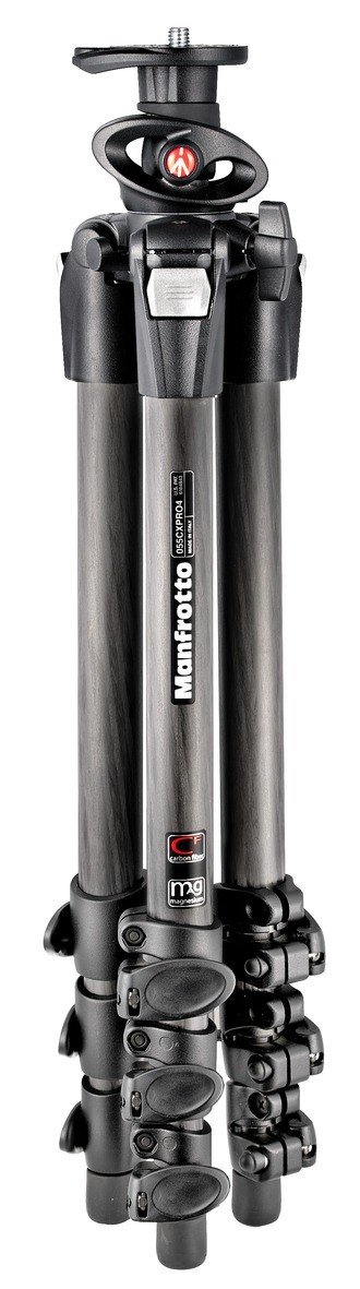

I'm currently at work so can't provide a detailed response yet, however, I can say that I have a 4 section, CF tripod from manfroto and I've never found it to be a problem at all: it's perfectly sturdy, and indeed I also upgraded from an 055 Pro.

I have the same 4 section manfrotto one as @Woodsy (I think...) and it's very stable, it's held my RB67 at near head height in reasonably strong winds before. If you weigh the tripod down with the bag hook, it's not going to be moving around much.
The calumet ones you have linked to have twist locks on the legs, which IMO are not as sturdy as locks with a clip action (example https://images-na.ssl-images-amazon.com/images/I/61OrecuUGpL._SL1181_.jpg) . It's easy to tell when a clip lock is not engaged properly, less so with a twist lock.

I prefer the Manfrotto clamps to twist grips. Never quite sure which way to turn them and there's always the potential for not fully tightening them.
I use a MT190CX three section tripod. Quite a bit lighter than OP's original tripod but approx £100 more expensive than his suggested buy. Solid as a rock and having three sections makes the bottom legs thicker. Plus fewer clamps to tighten/untighten.
I prefer the twist locks, means I can loosen/tighten all of the sections in one motion. As always, lefty loosy righty tighty.
I use a Gitzo 1-series, despite it being quite light and thin it holds my 5x4 and heavier Pentax 67 kit with ease. Packs down nicely and the leg locks are solid.
