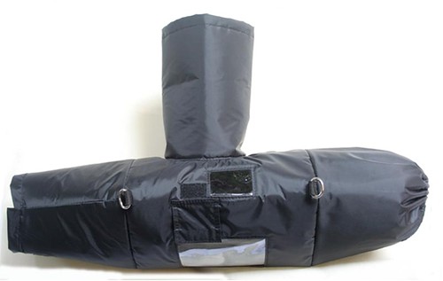

I did try this sort of thing, BUT and a big but, the kit I am trying now to cover for winter is
At the moment I am using clingfilm on all but the "flash window", ANY other suggestions would be appreciated.

Are you shooting snowboarding on this? I would image it does a fab job to overpower the Sun or snow. You can try sacrifice a fleece to wrap around the camera. Not sure about the flashes though, maybe as long as you can keep the battery boxes warm?

Handwarmers and a small wrap covering the batteries does that, my only concern is wet, as in snow etc, which was bad last year.
