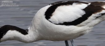

Most photos I took yesterday appear to be unsharp, like they're soft, others are better but are soft etc.
View attachment 425653View attachment 425654View attachment 425655View attachment 425656View attachment 425657
Are those still heavy crops ? To be satisfied what the lens is capable of I'd suggest a controlled test shot in decent light on a tripod e.g. cereal box in the garden. I know people may say that's not what you are going to be photographing but it will give you an idea of the capabilities of the lens. If those shots look OK it's ruled out being a lens issue and can move on to look at technique, atmospheric conditions etc
100% zoom in Lightroom
Edit: I've read that heat haze can be effect the lens when it's warm inside the hide, and it's cool outside.
This one isn't too bad. I'm happy with this one.
I think I need more light, but the photos I took should be sharp.
I used animal and eye detection. Some photos couldn't detect the eye and the body was shot instead.

even this is not that great. Sharpen AI perhaps, but really this has at most 5K real resolution in it.
Also seems that R5 is pretty unusable above ISO 3200... not much different to 5Ds. Actually I wouldn't be surprised if AF accuracy goes down the toilet when you start seeing noise. R6 seems to behave the same way; it works great until it just starts missing everything in fading light.
