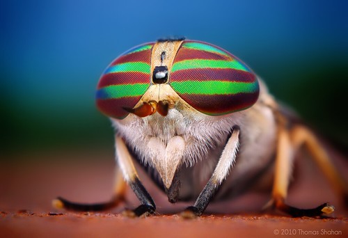

You can get magnification to achieve things like this
[/url] Robber Fly with Prey (Holcocephala fusca) by Thomas Shahan, on Flickr[/IMG]
Female Striped Horse Fly (Tabanus lineola) by Thomas Shahan, on Flickr
Not mine by the way Should I add. This chap has been interviewed in TV in the States for his work and check his video clips on youtube, he uses a Pentax with a handmade flash diffuser and reversed lens
