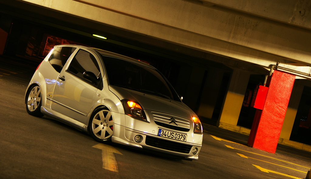

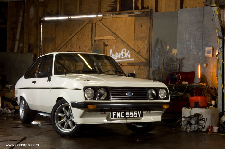

the main kind of shots i will be doing this kind, im at a happy stage with my panning shots for moving cars at track days and events etc, however i need good lighting for static shots. These are examples of the kind of shots i want to be able to pull out with this. Shots are taken mainly from other users on here but they are to give you an idea of what im after

I'd be looking to practice mainly on my daily runabout, a c2 similar to the first picture only not as low as that and in black.

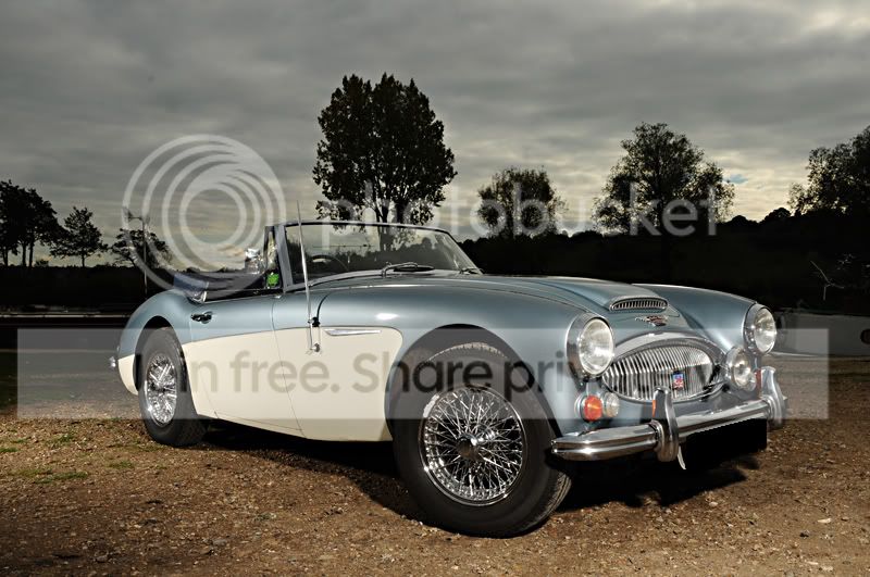

You could work with small flashguns etc, but I have the Lencarta Safari with two heads And did this.
You could use the Safari with flashguns triggered with the same type of trigger/receiver kit (RF602 with four receivers for example)
The cheapest is with the 462 from Yongnuo at about £24.00 each on the bay or the 460 MKII £40.00 approx.
