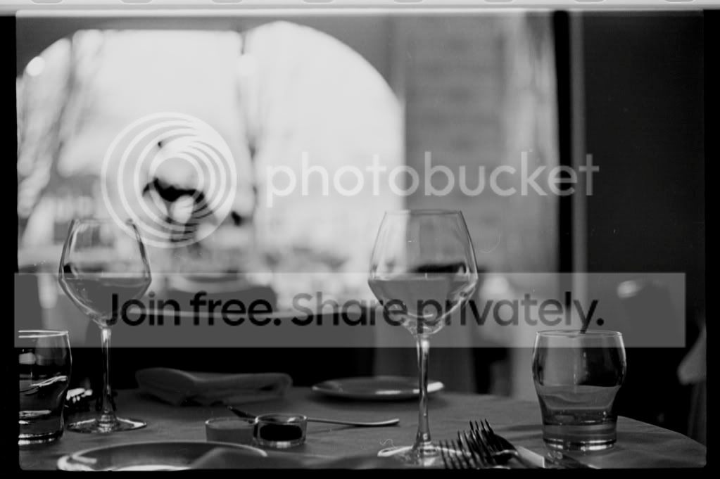

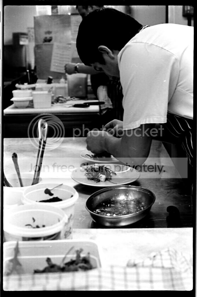

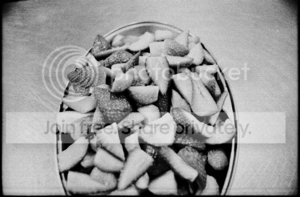

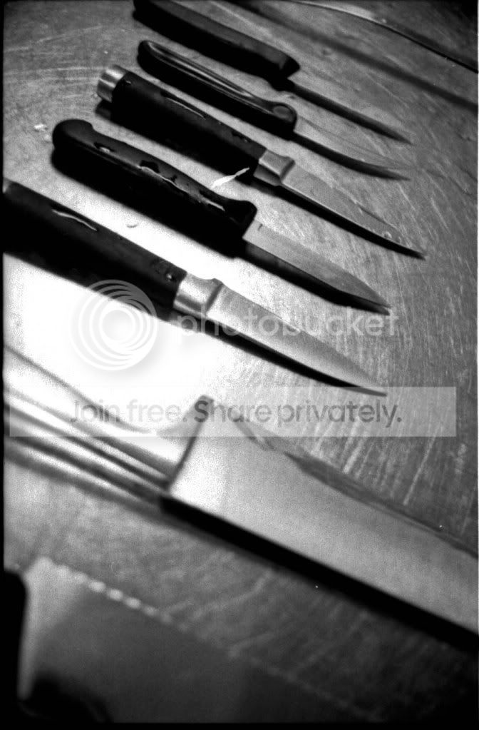

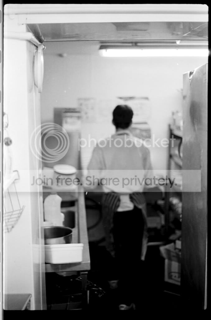

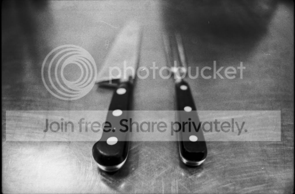

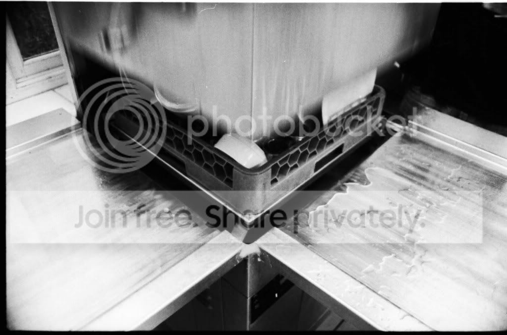

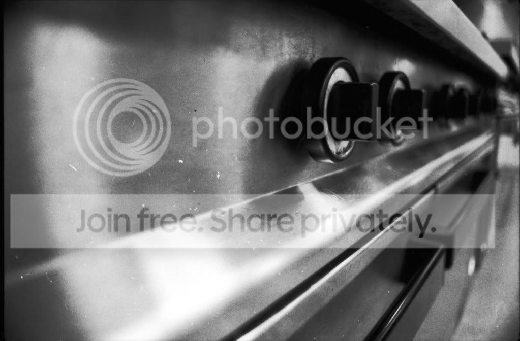

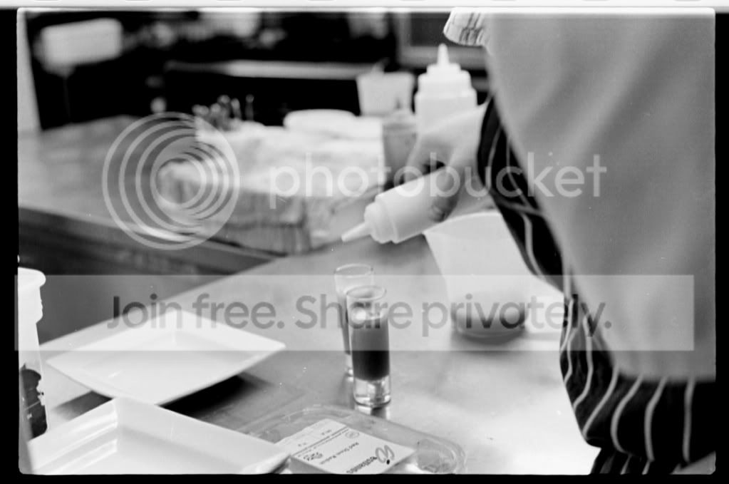

ok so as promised here are some test shots for the project
It would appear that Tri-X has served you well! The last knifes one is my favourite from the set, definitely. How wide was the lens?

Really happy with the test and i have to say thank you for your help so far. I had an expert on hand for the developing, my bruv. In his third year of uni and knows his way around a darkroom.
I was shooting with both 50mm and 28mm. The knives were shot with my 28.
And yeah, 35mm format then scanned in at medium resolution just for ease of transfer and the such.
