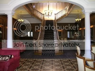

Guys - i've now got a pic of the staircase....any thoughts on how to approach this one ?
I've got one of those plastic velcro attached bouncers - might go with that i think.
6 people shouldn't be any problem - looks like there is ceiling to bounce off too. If they are going to be in costume - you might want to light it 'in period'.
How much time are they giving you for the shoot? If you have enough time I'd be using studio flash units for this.
Just a question out of interest - how did you get this job when you don't really have the knowledge or equipment to shoot it?
