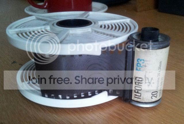

It's easier to make sure you don't rewind the film all the way. Then you can cut the leader off straight and start it in the reel before putting it in the changing bag. When you get to the end, the film will tear against the slot in the cassette. No need for bottle openers or scissors.

No it's easy as long as you don't dismantle the cassette first. Leave it in the cassette (make sure you don't wind it fully back in, otherwise you'll need to invest in a leader retriever), cut the end square, then chamfer the corners a tiny bit to 45 degrees and wind it back out through the slot on to the spiral. You can feed the first couple of inches into the spiral on a Paterson tank as far as the steel balls in daylight like this:
then put it into the changing bag.
