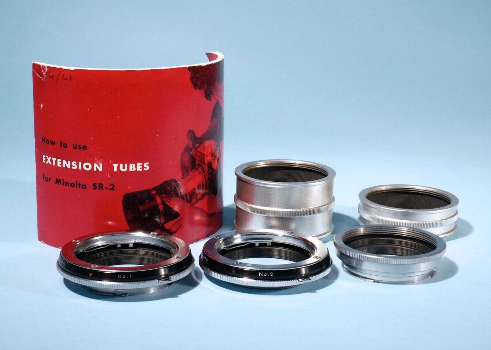

One set looks like this
Minolta Extension tube set by Kell, on Flickr
The other set says the thinnest extension tube is 7mm, but it's a two-piece system and I haven't measured how thick it is when the two pieces are clamped together.
