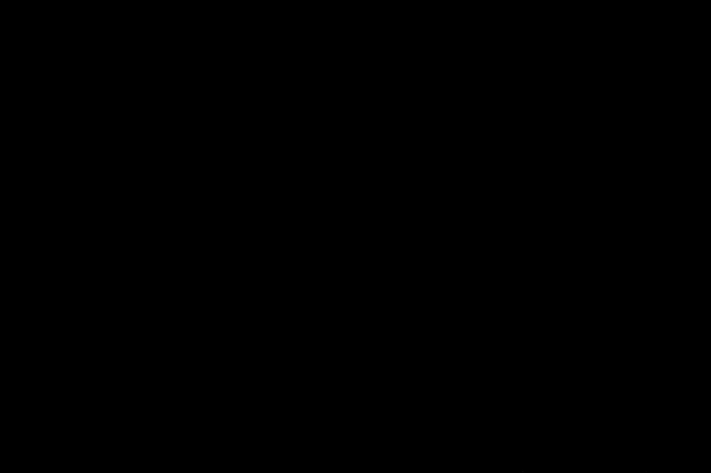

New body received yesterday. No amp glow on this copy...
