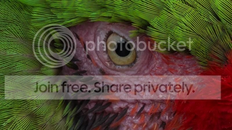

this is a crop down to 1161 x 654 @ iso 800 of a Parrot that was mooching around on a fence post.
Albiet not perfect and on a 60D and not a 7D there is not the mush or lack of any detail shown above, ...

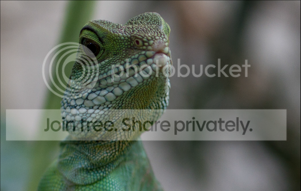

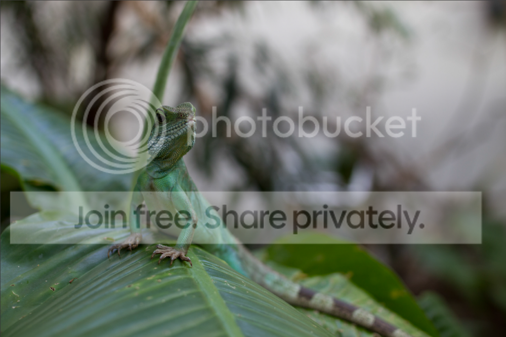

While I was on holiday I shot several shots close up of a lizard - static subject, a very good lens (70-200mm f4 L IS) with IS switched on, and still the focus missed on a few shots.
Last week I did a hard reset of all the functions, and somehow this meant that when I reviewed the images on the rear screen the focus point showed up as a little red square (it didn't do this before - possibly one of my settings). After the reset I did get a higher percentage of hits, but still a lot of shots where the focus was not on the af point.
These were not easy shots - small birds flitting around at close to minimum focus distance on a 400mm lens, so maybe I'm expecting too much, but once I changed back to my 1d3 the hit rate was much better.
I'm learning that a lot of the noise issues can be controlled in PP - possibly not the way it should be, but it can be controlled, and looks better in print than on screen.
Maybe I have a bad model, but now I accept that I will get a lower than expected hit rate af wise, but when it gets it right, the results are very good. Still reach for my 1d3 first though!
