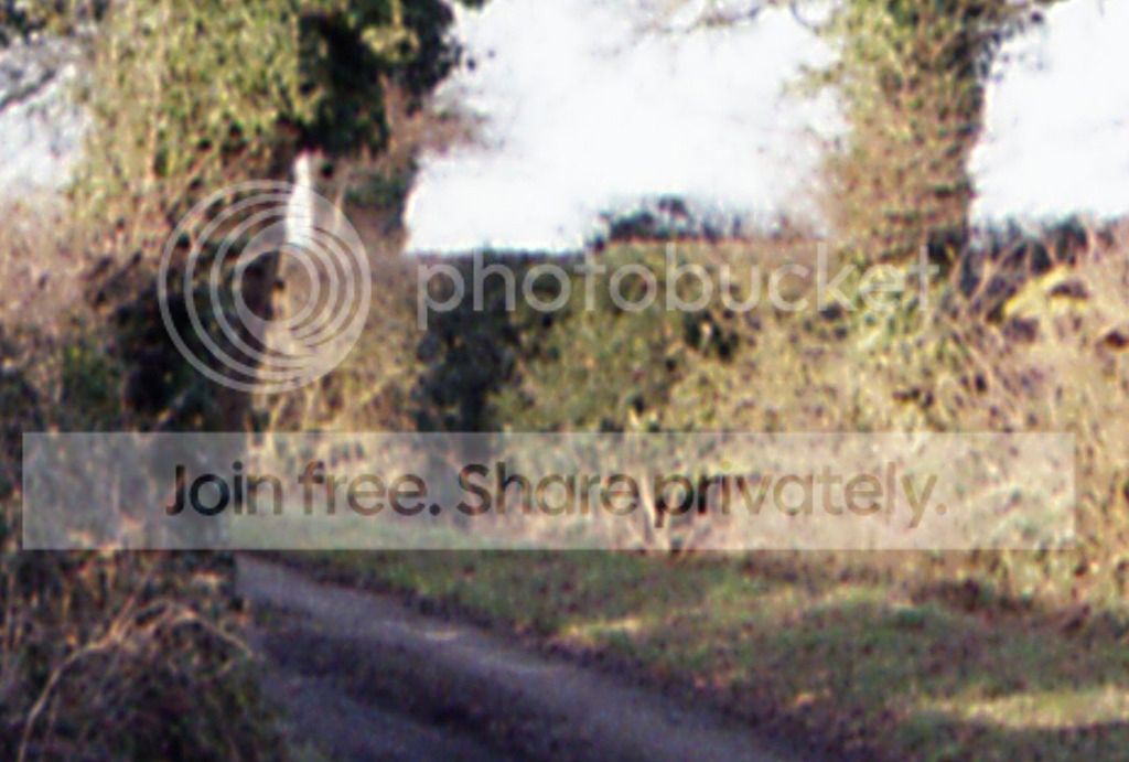

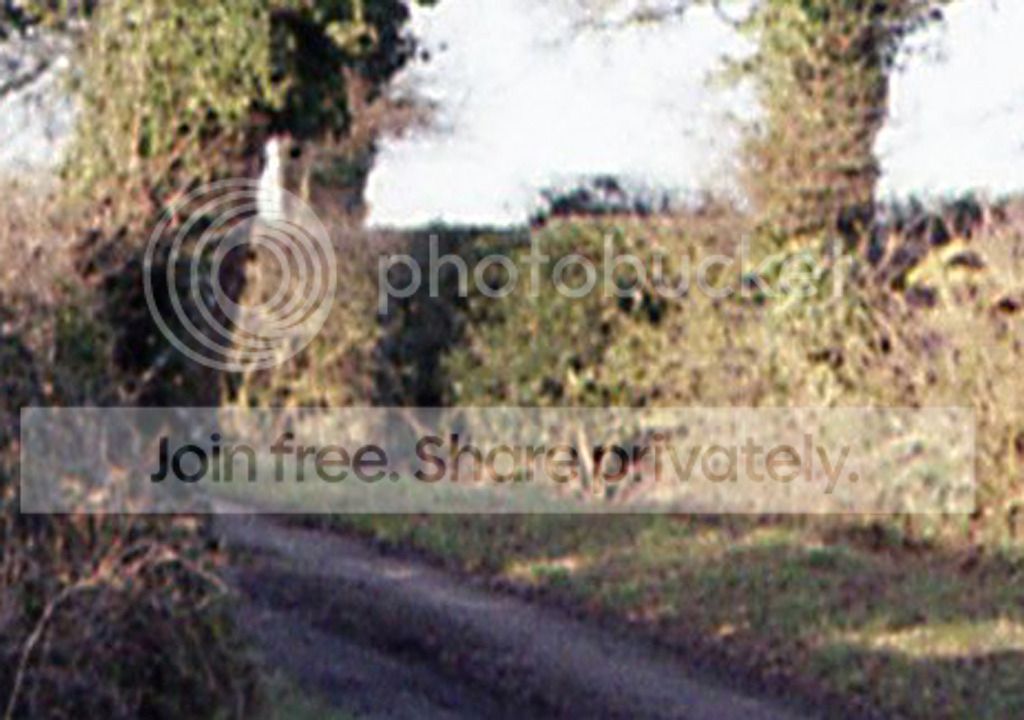

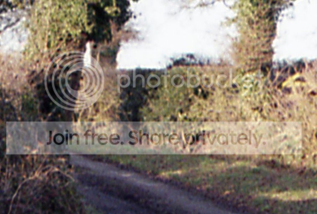

As a quick test, here're three 100% crops of a scan from my V5500. This was shot on Agfa Vista Plus 200 with my Olympus Trip 35. Other than the image (and file) size, I can't see any significant difference in detail when viewed at full resolution in Lightroom - the 4800 scan is just bigger. I CAN see actual digital pixels when viewing the 3200 & 2400 scand at 2:1 enlargement, but only just - and I can see them at 4800 too if I look carefully. Based on this I think I might drop my dpi settings to 2400 (for 35mm at least).
EDIT: As has been pointed out below, this doesn't equate to how shots will look when printed on actual paper. It's just an example of the effect of the dpi settings on the digital file (using my V550 and on this particular shot).
The sizes below refer to the full image, not the cropped section.
4800dpi (4175 x 6607 - approx 27.5mp 157Mb file)
3200dpi (2783 x 4405 - approx 12mp 70Mb file)
2400dpi (2087x3303 pixels - approx 7mp 39Mb file)

As a quick test, here're three 100% crops of a scan from my V5500. This was shot on Agfa Vista Plus 200 with my Olympus Trip 35. Other than the image (and file) size, I can't see any significant difference in detail when viewed at full resolution in Lightroom - the 4800 scan is just bigger. Based on this I think I might drop my dpi settings to 2400 (for 35mm at least).
