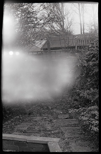

I bought a FED-3 for the grand sum of a £2 plus postage last year. Amazingly everything worked, though it was described as untested by the fleabay seller (which usually means "I've tested it and it's munged!"). It worked fine for the first half of the test roll, then the shutter delaminated (the shutter is a pair of cloth curtains with a rubberised coating to make them light-tight) leaving the shutter leaking light like a sieve.
Test Shot...
Fed3 - Test reel - frame 30 by The Big Yin, on Flickr

After a bit of reading, I found that the shutter curtain can be re-coated with latex based fabric paint. After 3 coats, each allowed to dry overnight in the airing cupboard the shutter was back as good as new (i.e. it ran a bit slow and wasn't totally consistent, just like most Ruski Rangefinders :lol:)
