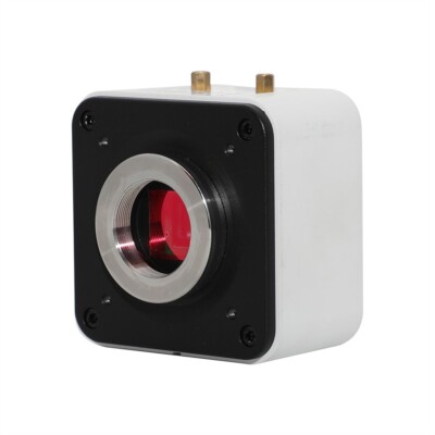

As per the posts above, the sensor is a 1/2.3” sensor that’s used in dashcams and microscopes (6.17mm x 4.55mm);
Hence the need to place it about 47 feet back from the film plane to cover any kind of frame, and it looks like it’s focusing on an image projected onto a secondary ground glass held at the film plane, hence the description of the images it produces;
“The result, as you can see in the photos published here, is something very special: although it is digital, it keeps the genuinely warm and grainy vintage pictures.”
Basically, it’s going to give a terrible image that is nothing like a ‘proper’ digital MF back.
