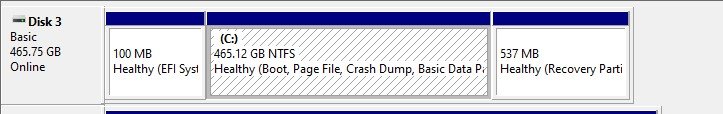

I would need to have a read about such scripts etc but can I ask, just how big does the WinRE partition have to be?
In Disk Management I note that the 'Recovery Partition is 537MB
The KB document for the update states you need 250MB free space in the Recovery Partition.
Hmmm? so even @ 537MB there is not enough free space in that partition :thinking: but how can you check the amount of free space when it cannot be 'revealed' using 'show hidden folders & files'.

On the matter of WinRE free space, I surmise that it is best to increase the partition by at least 250MB to be sure that there is/will be enough free space in total?
Yes; that's basically what the script does.
