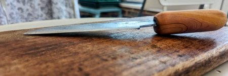

Huge thanks to @Graham W for the "loan" of his sharpening kit. It's bright a much neglected chef's knife back to paper slicing sharp in less than half an hour.
Also, I now have a knife I want to look after. Fancy Japanese steel? Nah, hand made in Kent :)PXL_20230618_160930926.MP-02.jpegPXL_20230618_165001917~2-01.jpeg
