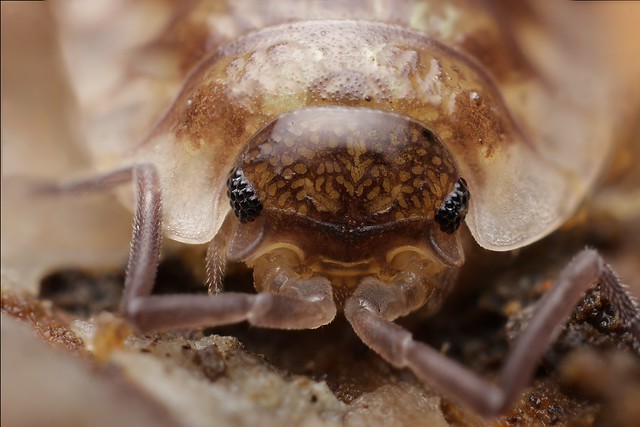

And a DIY set up like that can get shots like these:
Which are at about 3:1.
