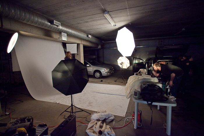

Century Media Records and graphics designer Jan Yrlund approached my buddy Eero and I to shoot the Finnish rock band 'Kivimetsän Druidi'.
The briefing we received was exactly that, brief, but what it did stipulate was that they need head turning, winter promo shots for their CD sleeve artwork.
It's January 9th and -24°C outside, the band made a firm assertion that shooting outdoors was not a favoured preference. I also was a highly concerned with safety issues and for the lighting equipment in such cold temperatures, let alone if it began to snow.

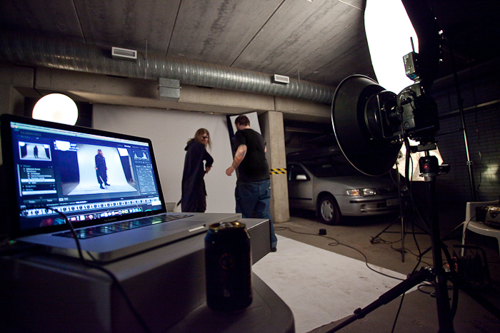

Thus a studio environment was installed in a previously arranged back up location, the unused garage area at Kouvola's newspaper HQ.
It's worth mentioning that as the garage floor was so dusty, safely gaffer taping the cables down was ineffective. We called a short meeting before the band entered the set and notified everyone clearly where the cables were and the where the safe entrance onto the cloth was.
Having someone trip over a cable a strip a light down is not something that anyone wants to experience and despite the messy appearance in the images here, both Eero and I were highly conscious of safety.
As the location was now going to be indoors and the icy background was going to be added in post, we would be blessed with the advent of a continuos power source, we were also provided with enough space to install the 3 meter by 6 meter backdrop cloth, which allowed much more effective extractions and layer masking in photoshop. The only issue was that our backdrop cloth was not wide enough to accommodate six members wearing medieval battle gear.
The total shoot time including the installation was around 8 hours. There was myself and Eero rigging up and striking down the lighting.
We knew that this would be a long day as we needed to shoot a variety of poses and at differing focal lengths from each member.
So in this particular instance, low power battery operated flashes are clearly not the best way to go. All lights were monobloc studio heads.
Had the shoot gone ahead outdoors, I would have suggested a sunset shoot, would have readily chosen multiple hotshoe flashes and taken a single group shot rather than a composite.
