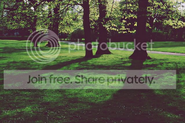

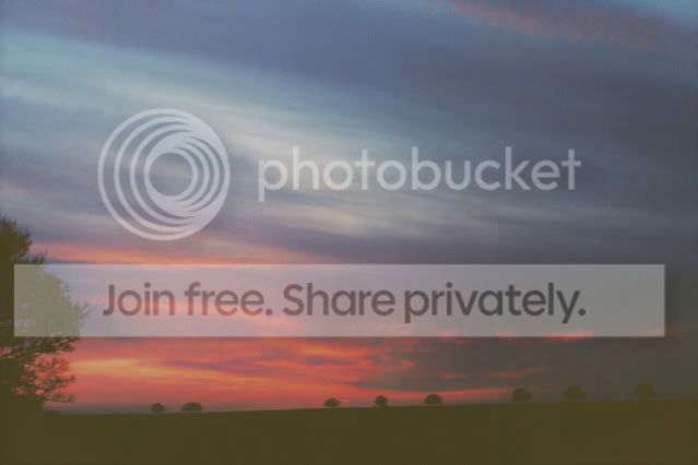

I got some velvia developed and scanned and the scans look terrible. A lot have come out like this:
Hard to tell on the teensy slides but they look ok. The blacks are black, not fuzzy red brown. Have they done auto-levels or some such on all my scans? Do all labs do this or can I get a straight, unaltered scan done anywhere?
If the slides look ok, its probably crappy scanning
Just a simple auto level brings the awesomeness that is Velvia screaming out.
What he said, crappy scanning.
Re scanning it is then. Now, to find somewhere that will do a good job of it...

To be honest I'd go back and complain about those scans with the original slides and ask why the scans are so drastically different. Their machines could have thought the slides were underexposed and tried to compensate perhaps?
I don't know of anywhere to recommend unfortunately as I got fed up enough to buy a scanner and just do it myself...

It was actually expired (knew that when I bought it though). I'd have put it down to that were it not for the fact that a few of the scans are absolutely fine. I'll see if the place that did them will re scan for nowt, then look in to the other places if they won't. Ta much :)
