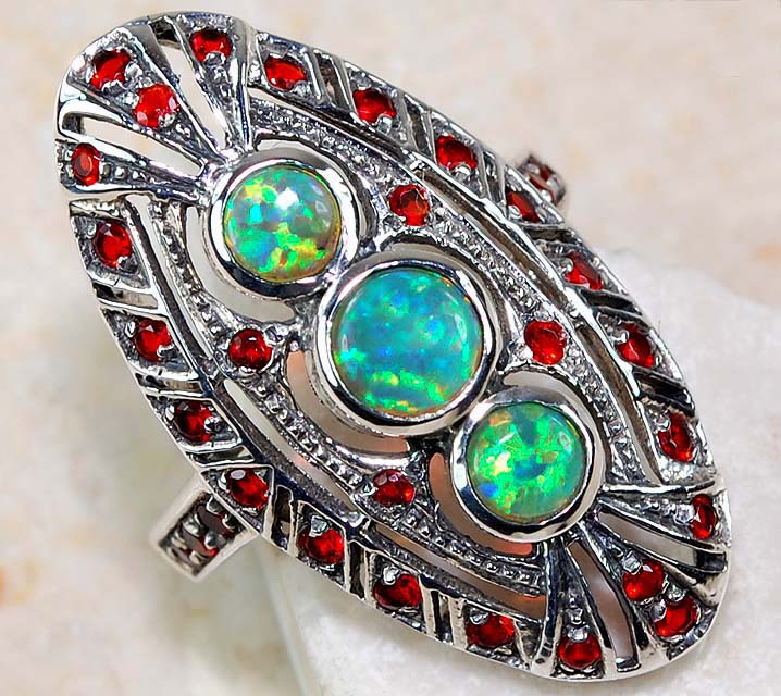

Beginner What sort of light arrangement is used in this photograph?
waferthin
6
This photo has been taken with a Nikon D40. Information from exif:
http://www.ringlovers.com/UV/UV-532-1.jpg
F-stop f/5.6
Exposure time 1/500 sec
ISO speed ISO-200
Exposure bias +0.3 step
Focal length 55 mm
Max aperture 5
Metering mode Pattern
Flash mode Flash,auto,strobe return
35mm focal length 82
I can see 6 bulbs - 3 on either side - in the reflection. Does anyone know more about this arrangement? Are the bulbs always on or do they work as a flash?
Is a separate flash also in use here, along with the bulbs?
Staff Edit: Please do not post pictures that are not yours, instead provide a link to its original location. Thankyou
I'm no lighting expert but they look like energy efficient light bulbs to me and then direct flash in the middle.
Not really the optimum lighting solution for product photography really...
edit: in fact with my monitor brightness turned up you can see they are some sort of Angle-poise lamps.
What Ned said.
Frankly it's awful.
Lighting an object should enhance it, to show it's properties.
The central gem has become a reflector for a bunch badly positioned lights.
Ask yourself; do you want the object to be the subject or some random blobs of light?

I thought this may be some sort of standard way to light jewellery. I selected the image because it shows the lights in the reflection.

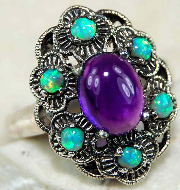

Here is another image without the reflections. It shows all the details and colours quite well - in my opinion.
http://www.ringlovers.com/PAZ/PAZ-547-1.jpg
