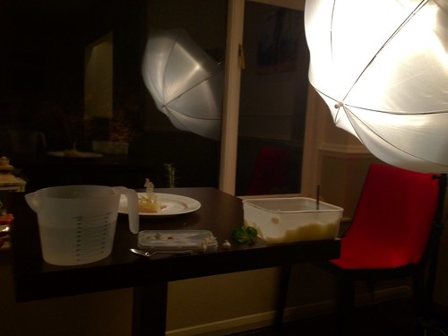

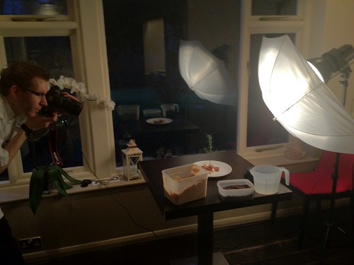

here is his set up,
Untitled by lewis wilson, on Flickr
right he has a canon 7d and at times was using a canon 100m marco and 50mm.he had the light plugged into the camera and was shooting away.
he got the light, umberlla, stand and cable from jessops in a kit for £250, i cant seem to find any deals, but not even sure where to look, i`d love to get a set up like that for my D5000, maybe cheaper but i think having this at work would be great fun and make the food look better than taking with our phones.

He has used a shoot through umbrella that spreads light everywhere and destroys all control over the lighting - you can do so much better than this simply by using a softbox to create soft light, and a reflector to push some light into dark areas.
And a second flash head, with a honeycomb fitted, would reveal the textures of the food and make them jump off the page and hit you!
There are no rules, but as a default starting position for product photography, something like this link, in this position, plus a reflector to fill-in the shadow side near the camera. That will get you something passable, possibly pretty good, and you can build from there. This is basically what Garry is describing above.
Far better position than the front-on brolly shown above, and more controllable, with lovely highlights glistening off the food. Watch out for flare with the light coming straight towards the camera. Put a grid on it maybe, or just shield the lens with card. Always use a good, deep lens hood.
