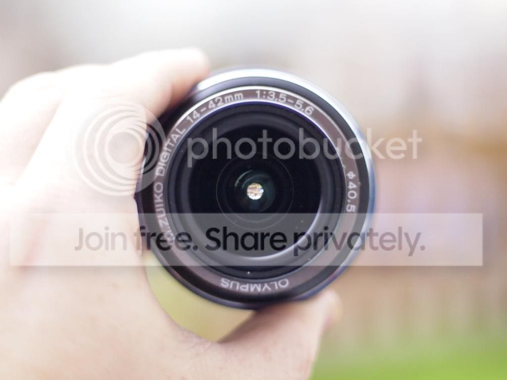

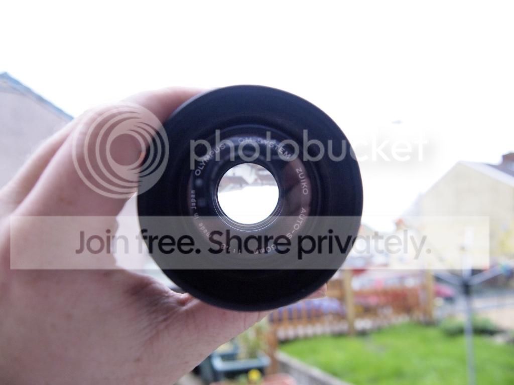

Here are some pictures of the lenses on why I reccon the old lenses let in more light. You can clearly tell the difference between the two.
The original 14-42mm that came with my PEN.
And the 50mm prime OM lens.

As for more light yes you are 100% right - the aperture is much larger on the 50mm. The F number defines this - it's a fraction of the focal length so the largest opeing on the 50mm is 1/1.8th of 50mm in diameter (27.8mm dia.) and the m.Zuiko is 1/3.5th of 14mm at the wide setting (4mm) and 1/5.6th of 42mm at the long setting (7.5mm).
That's because the 50mm has an aperture (hole size) of 1.8 and the 14-24 has a maximum hole size of 3.5 which is far far smaller.
That 'old' 50mm 1.8 will have the same size hole as my recent Canon 50mm 1.8 or that from any manufacturer.

The one fitted on the 50mm prime in the picture is a SUN skylight (1A). I have no idea what it does, it was just on it when I got the lenses from my dad. I am still learning and new to all this photography jargen:thumbs: Keen to learn though and can't wait to get better.

The two lenses should let the same amount of light in at the same aperture settings - the difference you've observed is the much larger maximum aperture of the prime lens. Don't put an ND filter on unless you have a desire to shoot wide open in sunlight - it won't help with the aberrations, they're just a feature of the old lens.
