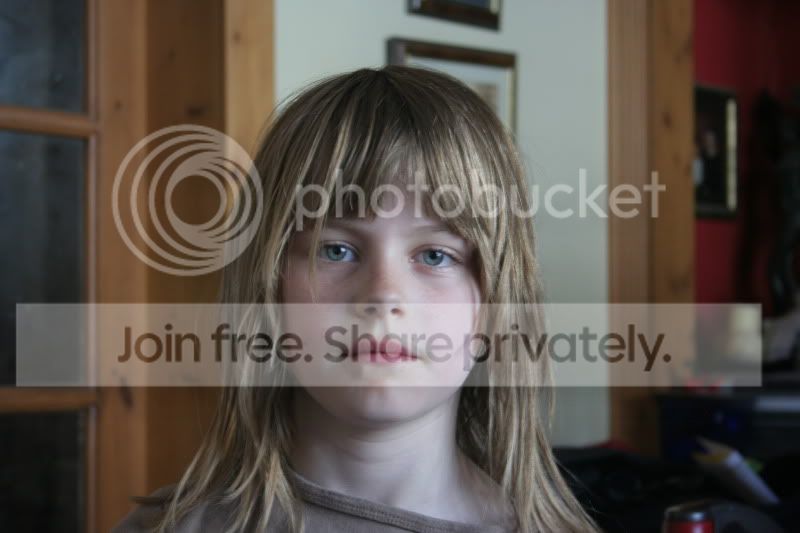

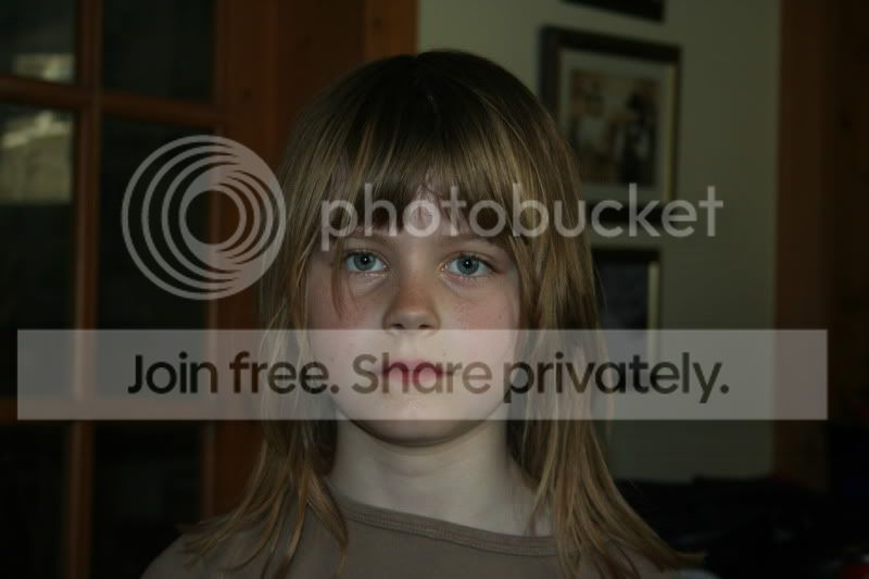

As im playing around with the settings i took these two photos of my daughter
1st using the Av setting on the canon 350D 1/10 5.6
2nd using the auto portrait mode 1/60 5.6
Although she could done with a good scrub up before becoming my model today why are these photos so different, as she never moved in between me taking the shots
Not sure what you mean by 'wrong' with them?
Obviously, the first shot has a slower shutter speed (1/10) than the second (1/50), but they both have the same aperture value - f/5.6.
Because the shutter's open for longer in the first one, you've got more light in.. so it's brighter. However, it's also a little soft, so you've moved a little & introduced a bit of blur.
1st is taken at 1/10 second
2nd is taken at 1/60 second
I suspect the auto portrait mode bumped up the shutter speed to prevent camera shake ... or it triggered the flash ... looking again it triggered the flash.
when you say a little soft, what does this mean and what adjustments can be made to adjust this
yes it did trigger the flash.
But i would of thought that would make the 2nd photo more brighter

Lacking sharpness ... 1/10 second is slow enough to allow movement in the subject, or the photographer to introduce blurring to the shot.
The second where the flash fired is a lot crisper and sharper, the flash has prevented any blurring due to subject or camera moving.

It should, I am not familiar with how Canon flash works, it could be the metering mode you have selected.

This means the shutter speed used was too slow to be hand held. Increase shutter speed to at least 60th second to try and get a shot that is more in focus.
With flash use aperture mode at f.8 as a starting point and see how that turns out.

The main reason the two images are different is because in the portrait mode the camera has immediately detected that the shutter speed is far too long for safe hand holding (or preventing subject movement) and has tried to bump that up, and then been forced to introduce flash to make the exposure, as the ambient is just too low.
When you're bumping along on the limit like that the camera just hasn't got any creative scope left. Need to give it some light to work with.
I would stick to one-shot, and be aware of the handholding/focal length rule, which is, your shutter speed should not be longer than the focal length x crop factor, ie 55mm x 1.6 = 1/88sec.
Less ambient light getting through in the second one due to faster shutter speed, but flash has lit up your daughter's face.
Camera shake is evident in the first pic. Modern cameras should have no problems with focusing. if its a focus problem i.e. wrong focal point some part of the picture will be sharp. If none of the picture is sharp its probably camera shake caused by the shutter speed being too slow . As a rule of thumb your shutter speed should match the focal length of your lens. 50mm lens 1/50th second shutter speed. 100mm lens
100th second shutter speed. Even this won't always work if your stood or holding the camera incorrectly.
