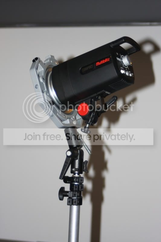

Practically any size you like if you use one of these with one of these. With this set-up the Softbox is supporting the light & not the other way round & I would also Locktite/Super Glue the stud in place on the base of the speedring, which has a standard 3/8th Whitworth thread.
If you have already got a (standard?) 152mm/6inch adapter then ask them to quote you for a plain speedring. More than happy with mine and certainly far better than the Calumet (Quickring) speedring I used to use this way in the past as it actually allows you to use an octobox.
Pic of the Calumet Quickring - so you get the idea.
Sorry no pics of the other speedring in use to hand
