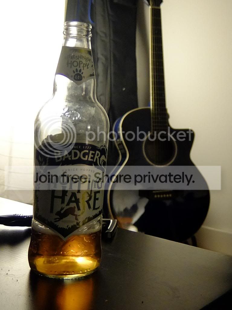

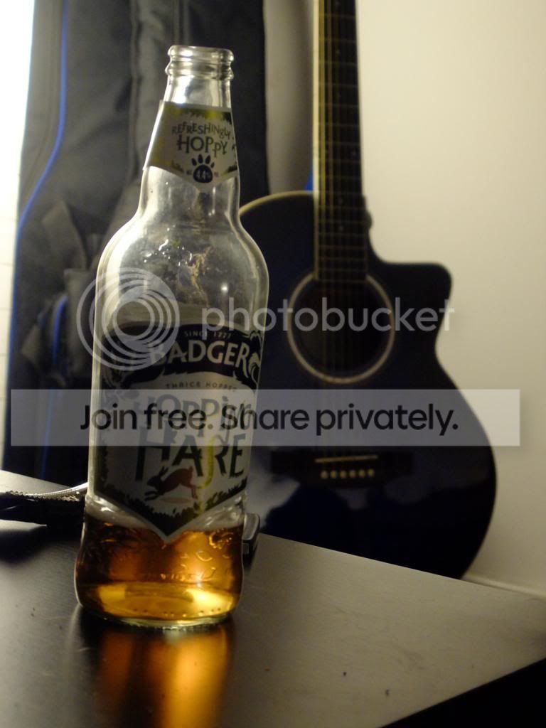

Ok, bear in mind its 1AM and I've had a beer and this is by no means scientific but hopefully it will demonstrate well enough :D
Both of these photos were taken from the same camera position, the first one was cropped and the second one was zoomed in.
As you can see, in the zoomed one the guitar appears much closer to the bottle than in the cropped image even though both were taken from the same camera position and have roughly the same subject size. Without the camera movement and focal length change you don't get the same dramatic change in perspective as seen with my beer.
Obviously I've done nothing with moving the camera and you will get very small changes in perspective as you move the camera back and forth but nowhere near as much as movement plus zoom.
