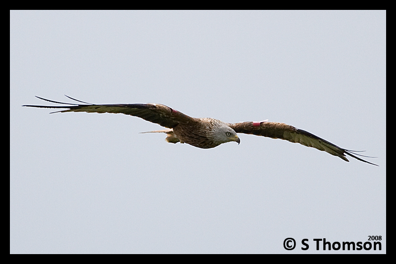

Take it you meen Argaty, was threr in the summer, I found it easier to set the Appature in AV, then select an area of grass and meter this, note the Shutter speed then switch to manual and set the Appature and the shutter speed, just need to re-check for changing conditions, think you will be OK with 300mm. as took this at 400mm
That shot was taken on the 11 July, got to the centre after the feed, but was still several birds around. were coming close enougth to get some good shots, I personaly think if you meter of the grass and manualy set both Appature and Shutter you will be fine, tryed AV first but got mixed results with the shots as a fair few the Kites were dark. One thing I do remember is that the farm was in the middle of nowhere and therfore not the easyist to find, and it is a bit of a walk from the car park to the hide.

If you want to use AV to deal with changing light conditions - you simply use your exposure compensation button.
Looking at the shot above, Av would underexpose that by about 1.3 stops - so simply dial in +1 1/3 stops with the exposure compensation button. Check the first couple of results on the review screen and adjust a tad if it is wildly out. That way you will get far more successful shots than keep on metering off the grass (which works, or grey tarmac, or your hand out in the same light) - while you are metering off the grass you can not be looking for the shot. Using the exp comp method keeps you looking at whatever your subject is.
At 40m the depth of field, even on the 300 + tele con. will be as much as you need.
Shoot RAW, so you have more latitude for correcting the shots when you get home. Edit hard and THROW AWAY all the dodgy ones- it is only the best that are of interest. If you have 3 much the same - edit them down to the best, even if you can only junk one of them, that is a 30% saving on space, time and effort for the same reward. That goes for anthing, not just kites.
