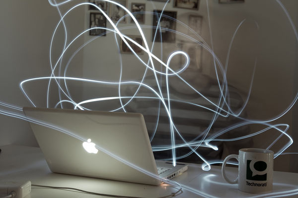

What I want to do is do the "basic" light painting, something like this:

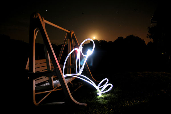

Some slightly more complex things like this:

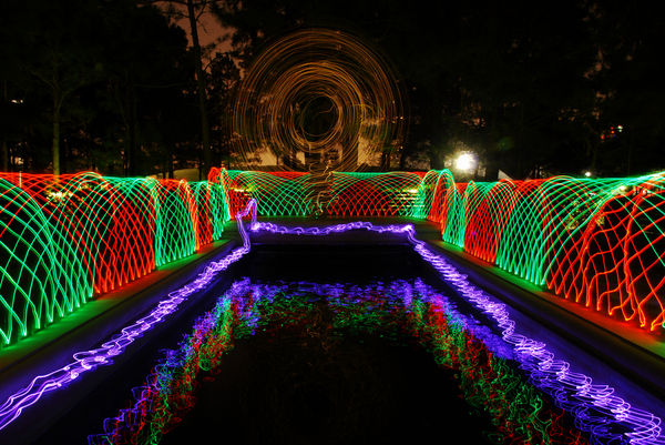

and the orb stuff like this:

The first two will just be a fairly standard torch :thumbs:
The others will be mostly made up of tools made with battery powered Christmas LEDs
The last one is likely again Christmas LEDs used for the orb taped up to make a cluster and I'm guessing a cluster laser for the light painting onto the ground of the last one

Right having looked a bit closer now that I'm on my proper computer rather than phone/ipad the one that I wasn't totally sure about was the water reflection shot...now looking at my guess would be that the green and red was done with pole (broom stale) with LED's spaced along it...this has then been moved in a consistent ark type movement to get this effect...I suspect the purple light is just a couple of LED's on the end of a pole that have been turned on and then moved around as seen here

The one with the water (green and red arches) I was thinking was done with a wheel similar to the dome tool but rolled along the ground in a straight line rather than around a spindle at an angle as in the domes.
Looking at it...that could well be the way it was done..my only reason for not thinking that was it looks a little wobbly but that could be more down to the operator ;)
