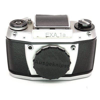

Not quite accurate. I looked to check the Edixas, but spotted the Exa 1a in the list. The very late runs of some Ihagee cameras (after the take over) used the Pentax screw rather than the Exakta bayonet. If I'd been asked, I would have said that the Exa 1as were all bayonet, and the screw was the later non-a models, but I assume I'm wrong.
What I can say is that the bayonet mount can be easily removed and replaced with a screw thread, so this may have been done to some copies.
Conclusion - a good list for a first check, but may not be 100% accurate for any given camera.
I have been having a closer look and I think that the 1a shown above has maybe had the model plate changed from 1b to 1a.
There are name plates for sale even now.
I didn't know there was such a thing as a 1B. how do you tell?
There wasn't.
The "1b" (note the lower case "b") had the Praktica M42 mount - so far as I know, it was otherwise identical to the "1a" which came with the Exakta bayonet mount.

I've just been looking at pictures of Exas. The shutter speed dials on the 1b and 1c were different to those on the 1a. The ebay photo shows a camera with the 1b or 1c dial, so a modified name plate.
