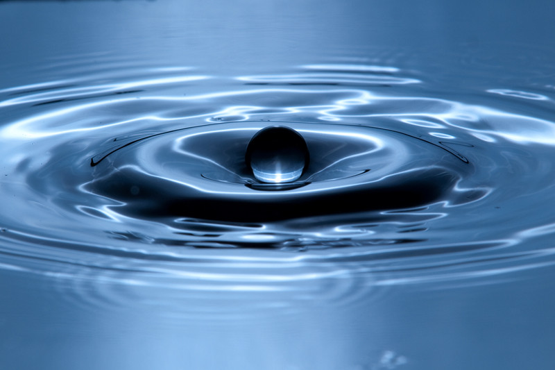

I can't remember the flash settings I used but they were quite low. If I remember correctly I shot in manual with the shutter speed set to 1/250 (fastest sync speed) aperture quite high (f/11 I think) then adjusted the two flashes to expose the scene. Then poked a hole in the glove and started shooting! Dunno if this helps, but I don't see the benefit of using cables to connect the flashes. If they work as optical slaves then I'd go with that (that's what I did)

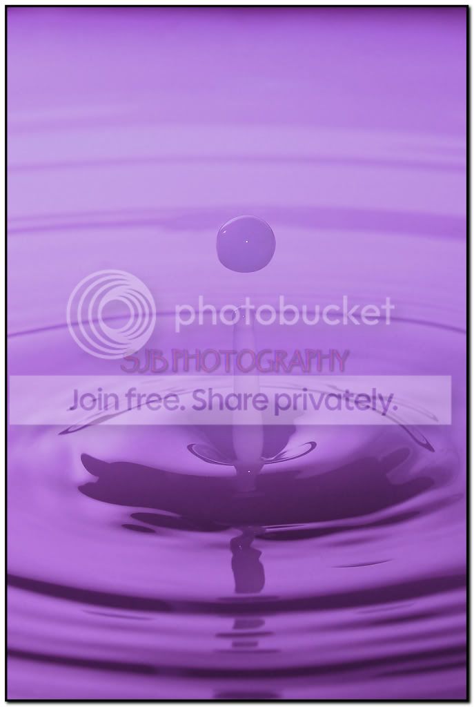

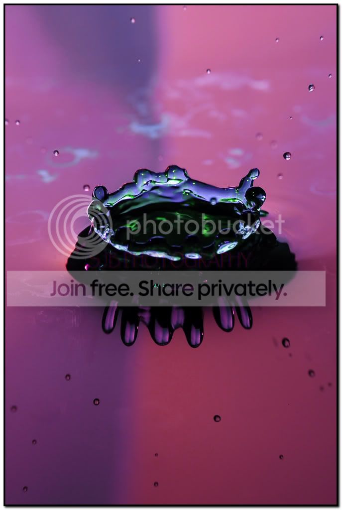

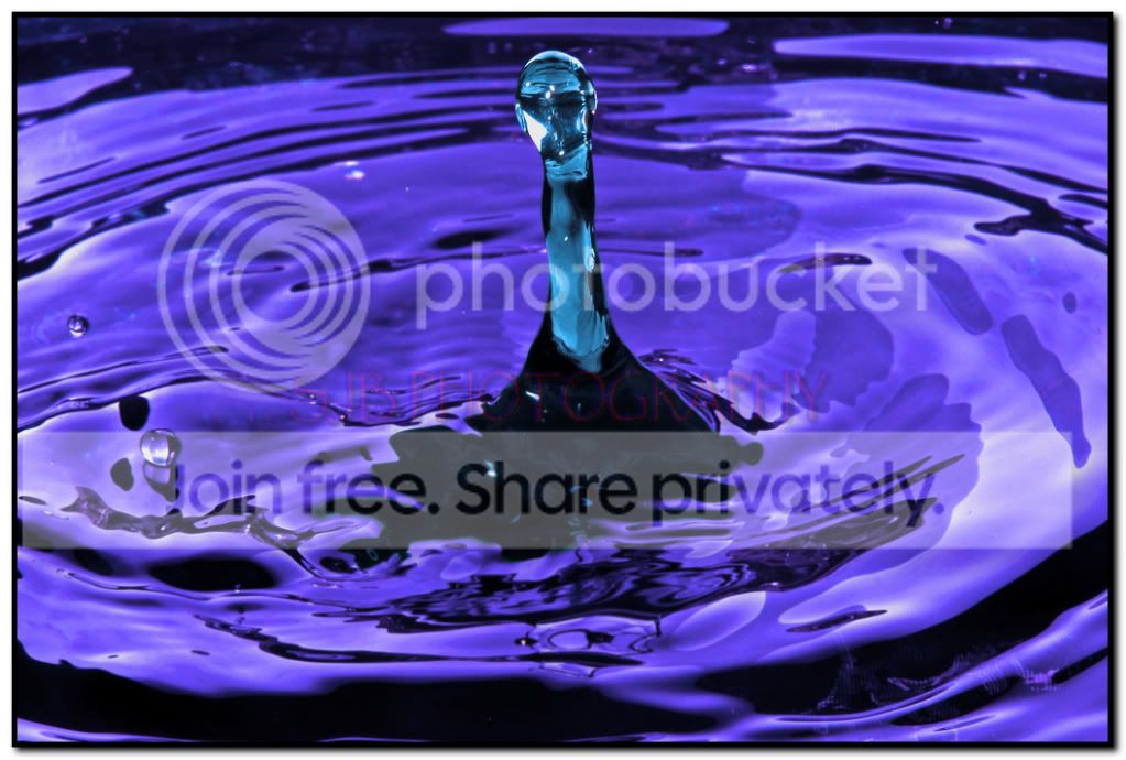

If its the former - I've no idea! If the latter I can offer what I learnt doing the same thing (incidentally I used 2 flashes too - one triggered wirelessly the other a slave)
Results weren't bad either!
