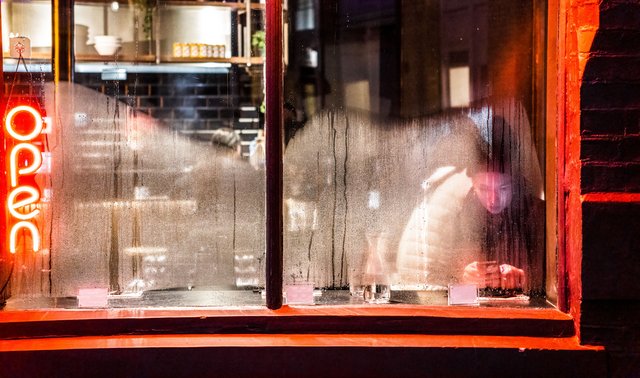

Hi guys. I shoot nightime street scenes that quite often involve orange, blue, red or green neon lights. But instead of the camera (Sony a6600) capturing the colour of the neon lights properly, it always looks washed out and whitish when viewing through the EVF at and after the moment of capture. I shoot raw and can bring back a lot of colour in post, but I can't get it the way I saw it.
For instance, I shot an orange neon sign that says 'OPEN' on the front of a restaurant. Shot at f2.8 and 3200 ISO. I also tried underexposing by using a much lower ISO and even increasing shutter speed and it made no difference. The main body of the lettering in my image looks whitish with orange around the outside of it whereas the actual sign is a vibrant solid orange with no whiteness.
See picture below. That's after processing raw file in Lightroom and trying to saturate the orange.
I get the same issue with the rear lights on cars, the red looks washed out, so it's not limited to neon lighting.
What can I do to ensure I capture the colour properly?

Well here's a couple of screenshots, the first straight out of camera with just lens correction in Lightroom, and the second is after processing. You can see the histograms. It's not a photo I'm going to use by the way, it's really a test photo. You can see that the neon sign in the before processing screenshot looks flat and red and it's certainly nothing like the vibrant orange of the actual sign when I was standing in front of the building looking at it. In the after processing screenshot, even saturating the colour of the sign doesn't reduce the white on the lettering.

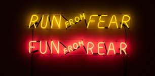

This was something I shot at the Tate Modern. I exposed for the highlights to get the neon lights more or less correct.
I didn't care about losing the background (a blank wall with wires running down it), but if I had wanted it, I would taken multiple shots at different exposures and prayed that the merge in PS sorted it all out ;)
In the two images you show in LR, the clipping light is lit. I suspect, as other have suggested, that the dynamic range is too high for this capture. I would normally always capture multiple exposures for street scenes at night.
Dave
Thanks guys. Yep, that seems to be the answer. Multiple exposures. I'll go back and try bracketing a couple of shots. One exposed for the neon sign and one for the rest of the scene, and merge. Street photography is a moving target but for a scene like this with a person sitting down, there's less movement and should be enough time for me to quickly capture a couple of different handheld bracketed exposures. Fortunately my Sony camera is quite quick between bracketed shots.
Perfect exposure. I'd have been very happy if mine came out like that. :D (y)
