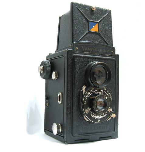

I think I already have the answer to this problem but would like input from you guys to be sure.
This is the camera:
Voigtlander Brilliant
Shot at 2012-08-28
This is the problem:
Lack of markings on the lens focusing ring...there does appear to be a vertical line just above where it says "gruppe"...possibly a scratch...If it is the marker for focusing then i have a problem as the lens is at this point screwed fully home which unless i am mistaken will be correct for infinity????
Shot at 2012-08-28
If I mark the lens ring at the point marked by the arrow with the lens screwed "fully home" then I'm presuming the lens will be set at infinity and will focus pro rata for the other distances as the lens is turned (unscrewed) anticlockwise......Is this going to work or not??
Shot at 2012-08-28
Casting my mind back to when i had a voigtlander brilliant
There was a overlay on the lens with a red arrow for focus distance, it went on the two holes you can see. It also limited the focus by hitting the 2 protuberances above portrait and landscape
your scratch is in the approximate place but you have your lens screwed in a turn too many
Its not exactly the same as yours but you can see the ring on top of the lens, which yours is missing
Thanks for your help Rob...Trust me to pick up a dud :bang:
So you reckon if I back screw the lens the best part of 1 full turn so the scratch falls on infinity all should work out ok with focusing on the other settings??.....well here goes nothing then :gag:
It should do, not guarantees though, it's been over a year since i last picked up my Brilliant
I agree with Rob about the part being missing my one is the early model same as robs photo, but the focusing looks the same but upsidedown compared to mine
with my one you turn the lens clockwise for portrait and anti clockwise for landscape..but yours looks like it works the opposite way round..
If I unscrew the left hand stop pin/screw from the camera ( the one by the landscape setting ) I can only just turn the pointer past where the stop pin was before the lens bottoms out and stops..if that makes sense.
I found some information on the web about the focusing distances once but cant remember where, but no doubt if you play about you should be able to get some reasonable pictures out of it.
I took mine apart and cleaned the lenses and after putting it back together was surprised with the images that it took..
I have exactly the same model as you, but mines got the missing bit on it.
Mine has a red pointer inbeteewn the two screws, looking at the front of the camera about 20 past it says portrait and 1.2m. 25 past is 2m around 25 to it says groupe and at 20 to paysage and the infinity symbol.
Hope that makes sense and is of some help.
Just read it back and I am confused :bonk:
