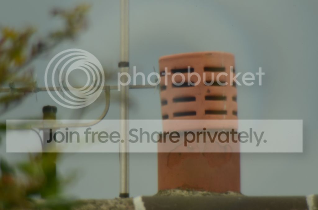

Here are some photos:
Above is as best as I could focus the lens at f32

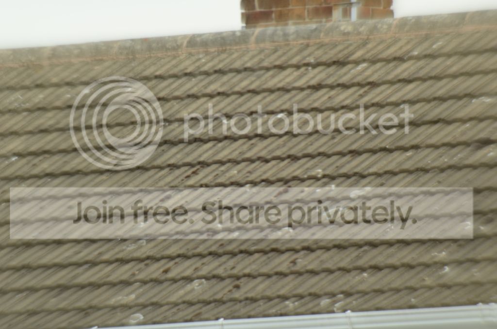

Above is the best focus I could get with the x2 teleconverter (which was provided in the box) again at f32

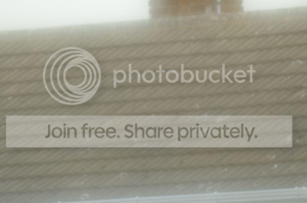

Again another shot at f32 and for comparison...

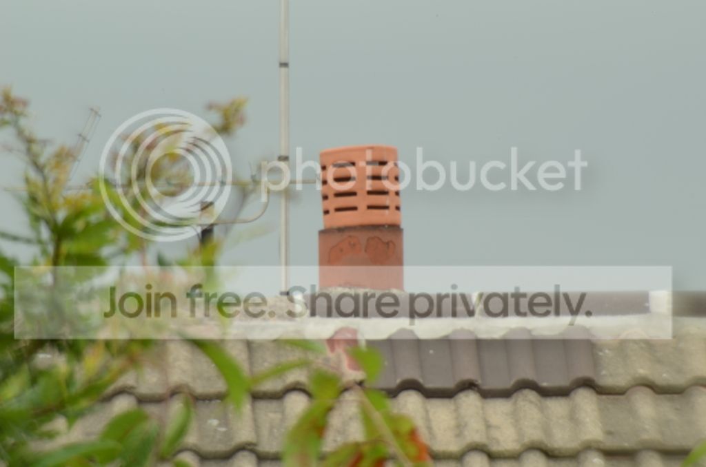

The best focus I could get at f8
I expected the lens to be on the basic side but from example images other users on the amazon page have posted I'm under the impression that its either me not using the lens right, the lens not being right for my camera or (what I suspect) the lens is faulty.
And I forgot to mention - its a manual focus lens, the camera itself is set to full manual and although I can see the focus changing when I turn the focus ring I can only really get focus at f32, and when I do its only in the very centre of the image - the rest gets increasingly blurred towards the frame.
Have you tried to focus on something closer, is it better, could be an infinity focus issue, ie, dodgy adaptor
That lens is faulty I'm afraid. I've used various lenses of these types over the years, and whilst they are limited, you should be getting far better results than that. As Hoppy says above, and element has been dislodged or possibly even been installed the wrong way around.
You shouldn't be getting that sort of problem 'even' with a cheap lens. It should all work properly even if it's not the best image quality. Return.
