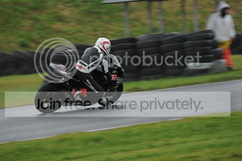

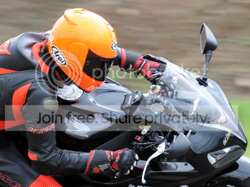

Thankfully, tracks over here aren't that restrictive and 200mm would be plenty enough reach (see the shot below) and for road races, well, you can almost stand on the road if you dare. The only advantage of the extra 100mm is to get a shot that'll need less cropping (see pic 2 below)

Poor light, in the rain, 200mm,1/250, f5.3, ISO 400
Nice sunshine, 125mm, 1/250, f8, ISO 640
